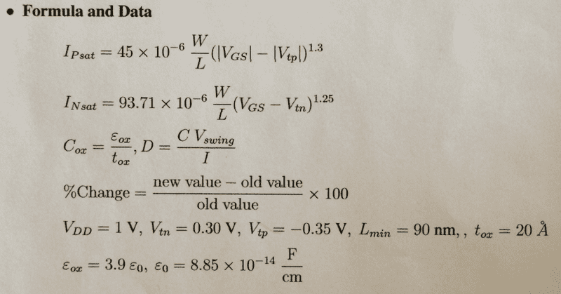

Consider ##Z = \overline{(A + B \bar{C})D + E \bar{F}}##. Assume primary and inverted inputs are available.
A) Implement the function in conventional CMOS logic style such that only 4 transistors are connected to the output node, and the PMOS and NMOS transistors with input "A" are attached to ##V_{DD}## and ground (by their source), respectively. Assume all PMOS have ##W/L = 15## and all NMOS have ##W/L = 6##. Place a ##50 fF## load capacitance at the output.
B) and C) I had no problem with.
D) Calculate the worst-case rising and falling propagation delays. Only consider the load capacitance and ignore the internal capacitances.
E) No problem.
F) Calculate the best-case rising and falling propagation delays. Only consider the load capacitance and ignore the internal capacitances.
G) Design the same circuit for equal rising and falling delays of ##100 ps##. Provide two sizing solutions and indicate ##W/L## of the transistors on the circuit. Identify the better solution with a reason.
##D_r = \frac{C_L V_{DD}}{2 I_P}##
##D_f = \frac{C_L V_{DD}}{2 I_N}##

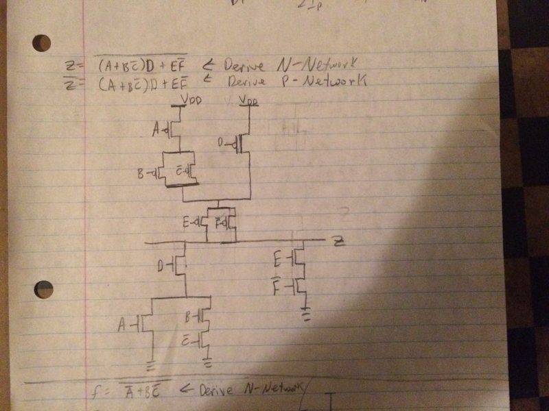

Here is my work so far:
I want to know if my answer to part A) looks okay.
I know the answers to B) and C) are correct.
D) To find the worst case delay, I have to consider the longest critical path or something along those lines. I am unsure how to do this question.
E) This question is doable if I can solve D) and so I won't need to talk about it.
F) The best case delay means all the paths are active at the same time. I am still unsure.
G) I will get to this.
If part A) looks okay, I need some help with part D).
Thank you.
I did some research and I found these important facts:
- Designing a conventional CMOS circuit means a PMOS pull-up network and an NMOS pull-down network must be constructed.
- The PMOS pull-up network and NMOS pull-down network must be complements of each other.
- The PMOS network must have the AND terms in parallel and the OR terms in series.
- The NMOS network must have the AND terms in series and the OR terms in parallel.
Using these important facts, I designed this much simpler looking circuit, which I believe is what I am looking for:
I hope that circuit looks okay now. I used both the primary and inverted inputs, and I believe I met the criteria. P.S: I didn't label the sizes.
Now part D) makes more sense to me.
For ##D_{rising}##, I need to consider the longest path through the PMOS transistors (there are four such paths at a first glance). I should compute ##W_P## from the minimum of the four widths along each path (using the result ##W_P = 1.35 \mu m## from part B)), and then use that to calculate ##I_P##. From there I can calculate ##D_r##.
Similarly, for ##D_{falling}##, I need to consider the longest path through the NMOS transistors (there are two such paths at a first glance). I should compute ##W_N## from the minimum of the two widths along each path (using ##W_N = 0.54 \mu m##), and then use that to calculate ##I_N##. From there I can calculate ##D_f##.
Part E) is quick.
For part F) I need to consider the best case delays, so I consider the circuit when all the paths are conducting. Then I should follow the same process as in part D), but there are only two widths to consider instead of six. I should use ##W_P = 1.35 \mu m## and ##W_N = 0.54 \mu m##.
For part G) I should use an equivalent inverter from the start and use the given delays to compute the respective currents. Then I should take those currents and compute ##W_P## and ##W_N##. Then I need to design the same circuit from A) using these new widths, but I need to make sure I design it so the PMOS network transistors can reduce to the equivalent inverter PMOS. Similarly, I need to make sure the NMOS network transistors can reduce to the equivalent inverter NMOS.
If that all sounds reasonable, I can relax.
