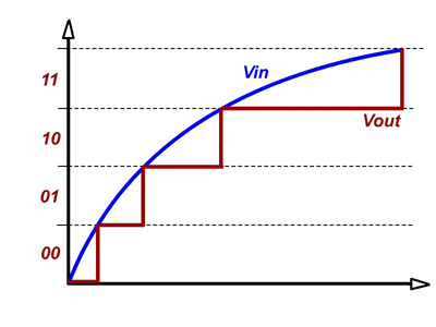

If you wondered why my program didn't have this. It is because I took my steps digitally like Vout in this picture:
Whatever the case. My acceleration would always be 0. And thus it would not be necessary to include in the function for distance.
