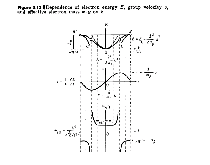

current is e*v. What happens to v upon reflection?
I think since the electron wave function is standing wave at BZ edge, v becomes zero;as this figure shows:
