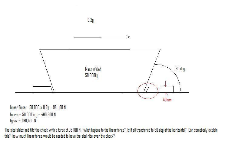

Hi,
Thought I understood this but i really don't. So i have attached a quick sketch to try and explain.
can someone explain what is happening in the sketch and how i would calculate the forces.
apologies if the answers submitted already explain this but i don't understand.
Note the sled and chock are both angled at 60 deg.cheersdave

The way to attack this is to find all the forces that must be acting on the sled to keep it stable. Then, see if those forces are physically possible given the geometry of the situation.
To keep it simple, assume there is no friction between the sled and the deck, and the base of the sled is not perfectly flat, so it only contacts the deck at its two ends and not all the way along its length.
The geometrical proportions of the sled (the ratio of the height of the CG above the deck and its length) affect the answer as well as the size of the sideways acceleration. Call the length L and the height of the CG position H. Call the weight of the sled W.
The forces on the sled are
1. Its weight W acting down at its center of mass.
2. A sideways force of 0.2 W acting to the right, also at its center of mass
3. The vertical reaction force V3 of the deck on the left hand corner (assume there is no horizontal force, because we are ignoring friction between the sled and the deck)
4. The vertical and horizontal compoents V4 and H4 of the force at the stop.
We can find V3 by taking moments about the stop.
V3 x L + 0.2W x H = W x L/2
We can then find the V4 by resolving vertically
V4 = W - V3
The horizontal force H4 is 0.2W (acting to the left).
Then check if V3 > 0, otherwise the left hand end of the sled will lift off the deck and it will topple over the stop (unlikely, unless it is very tall or the sideways acceleration is very big).
Finally, compare the direction of the resultant force at the stop with the 60 degree angle, to see whether the sled will try to slide up the stop or be wedged into the corner between the stop and the deck.

The question as posed stated "ride over the chock". You seem to be answering the slightly different question of "tip over the chock". Of course, that might be the question intended. (The dimensions of the chock were not initially provided.)
Not sure about some of your forces. Also confused about whether you're analysing the case of hitting the right-hand chock or the left-hand one.
The 0.2W is not horizontal. It is parallel to the deck, with the deck tipped at 30 degrees.
The reaction from the (smooth) deck is at right angles to the deck, not vertical.
If V3 is at the left corner of the sled when about to tip over a chock then presumably you're thinking of the left-hand chock. But then you take moments about (the base of?) the chock and find a nonzero contribution from V3. hence my confusion.
The net force from the chock (V4&H4) acts at right angles to the chock face, so at 30 degrees to the vertical, and through the corner of the chock.
If the chock height is h (measured up its face), and the normal forces from chock and deck are C, D respectively, the sway force from the rolling is X (=0.2W we reckon), and writing c, s for cos, sin of 30 degrees, I get:
Perp to deck: W.c = D + C.s
||'l to deck: X + W.s = C.c
Moments about chock/deck/weight contact point:
D.h = X.H + W(H.s - L.c/2)
Can eliminate C, D from these equations and obtain an expression for the minimum value of h to prevent tipping. (Could be negative.)

Hi guys
thanks for taking the time to reply to my question.
So from the information you supplied I got the following.
Mass = 50,000kg = 490,500 N @ CoG 2897(l),1545mm(h) (sled is not a uniform shape)
The length of the base is 5350mm (I assumed that because we're taking moments about the stop l should be the distance V3 and V4)
∴ V3 * 5.35m + 98,100 * 1.545 = 490,500 * 2.675m
V3 = 216,920 N
V4 = 490,500 - 216,920 = 233,980N
OR if L in the equation should have been 2.897N
V3 = 400,594N
V4 = 89,905N
Have I made a mistake since V3 is a positive number?
So for the resultant of V4, H4
From the first attempt above V4 = 233,980 and H4 = 98,100
= 253,712N @ 67° (so does that mean it will slide over?)
Next attempt
V4 = 89,950 and H4 = 98,100
133096N @ 43° (again does this mean it won't slide over)
I will add in the 30° roll in later but first can you tell me if I have done the above correctly?
