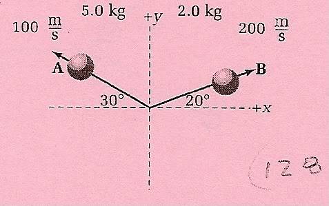

A grenade of mass 10kg explodes into three pieces in the same plane, two of which, A(5.0kg) and B(2.0kg), move off as shown. Calculate the velocity of the 3.0 kg third Piece, C

Isn't it really a matter of vector addition?
Pa = Ma*(-Va*cos30 i + Va*sin30 j)
Pb = Mb*(...
These added together give you -Pc don't they?

I was merely treating momentum as vectors and taking the components independently.
As an alternative method, consider the momentum in x and the momentum in y, separately.
Pax + Pbx + Pcx = 0
and
Pay + Pby + Pcy = 0
Once you have determined the components of Pc then you can use Pythagoras to give you Pc.
