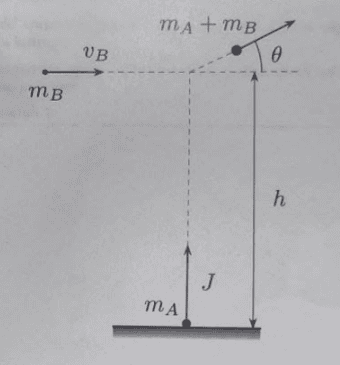

A body, of mass ## m_A = 2kg##, is initially at rest on the ground. ##A## is then subjected to a vertical instantaneous impulse of magnitude ##J = 10 Ns##. When ##A## has a velocity of ##v_A = 5m/s##, the body is struck in a perfectly inelastic collision by the body B. Knowing that ##m_B=0.2Kg## and that ##B## has a constant horizontal velocity, ##v_B= 5m/s##, determine:
1) ##h##
2) The energy lost in the collision
3) ##\theta##
4) The maximum height of ##A+B## after the collision

The main thing about this problem is to find the components of the velocity, ##v_{A+B}##. To do that you have to use the conservation of linear momentum of the collision. In this case, since there is an impulse, I should have ##\Delta P = J##. But the impulse is given prior to the collision. Does this mean that ##\Delta P = 0## in the collision? That's the thing I don't understand.
After I figure that out, I know how to finish the problem:
1)I Already can determine ##h## by writing an energy balance from when ##A## is on the ground to the moment right before the collision with ##B##;
2) Energy lost = ##|\Delta E_{kinetic}|## ;
3) Once I have the components of ##v_{A+B}##, I can determine ##\theta## with trigonometry;
4) Max height, ## h_{max}= \frac {v_{A+B}^2 (\sin\theta)^2} {2g}##.

The impulse ##J## they are talking about is applied only to mass ##m_A## (before the collision).
So yeah, if you are saying gravity (impulse) is negligibly small over the very short collision duration (##A## impacting ##B##) then for the collision ##\Delta P = 0 ##.

Also, don't forget that you are starting at ##h##, when finding ##h_{max}##.
Right, ##h_{max}= \frac {v_{A+B}^2 (\sin\theta)^2} {2g}## is valid only when ##h_{\text{initial}}=0##.
##\Rightarrow h_{max}= h_{\text{initial}} + \frac {v_{A+B}^2 (\sin\theta)^2} {2g} ##
