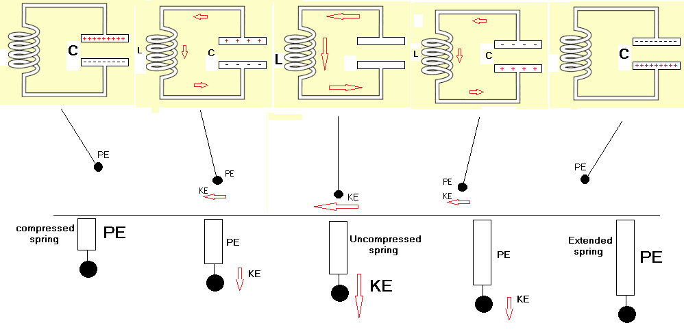

Everyone else can explain how you solve 2nd order DE without knowing an answer in advance, but the point made about the commonality of simple harmonic oscillators is useful. Perhaps I can offer a visual?
1- Capacitor has electrostatic PE.
- Pendulum has gravitational PE.
2- Voltage starts to drive current through inductor, losing some charge. Current through inductor creates magnetic energy
- Gravity pulls bob down. Bob loses some PE, but gains som KE.
3 - Capacitor has discharged. Current has increased to max. Inductor has max magnetic stored energy.
- Bob at bottom has lost all PE and has max KE.
Does the bob just stop here? Can the current through the inductor just stop here? (Clue: No to both.)
If it causes you any problem, you need to understand more about inductance.
4 - Inductor continues driving current in circuit, losing magnetic energy as it does so. Current starts to charge capacitor.
- Bob keeps moving and rises gaining PE and losing KE.
5 - When all magnetic energy is used, inductor no longer drives current into capacitor. Capacitor has max charge.
- Bob reaches max height and stops. It has max PE and zero KE.
That's half a cycle. The next half cycle is a mirror of this.
If there's no friction of any sort, the pendulum can continue undiminished oscillation. Similarly the LC circuit would continue to oscillate IF there were no losses, but there always are.
The same sort of thing can be done for a Spring - Mass system, where energy exchanges between PE of stretched or compressed spring and KE of mass.
All have a relationship between two stores of energy.
Likes Lord Crc and zoki85
Merlin3189 said:
https://www.physicsforums.com/attachments/259381
In case of L(R)C circuit oscillations, the analogy mechanical system-electrical system works great.
Spring-Mass analogy works even better than pendulum. For the pendulum the undamped oscillation is just aproximate sine (it approaches sine for small angles) while linear spring-mass is pure sine.
Likes sophiecentaur
Yes. I first thought of that, but drawing springs is harder than drawing strings!
But you're right, it's a better analogy.
Edit: I've given up tying to draw the springs, just used boxes! So I've updated the diagram.
But it I didn't like the look of it horizontally, so it is vertical. I just hope people won't worry about gravity. It all works out the same, but people might get into a fuss about different sorts of PE.
Any further suggestions welcome.
Likes sophiecentaur
