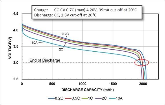

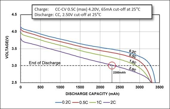

As previously noted batteries have a total energy capacity given in amp-hours but the actual energy that can be extracted from a battery often depends on how fast the energy is extracted. The discharge behavior of a battery is described by a graph of the terminal voltage versus capacity used for different discharge rates called C-rate. 1C discharge rate discharges the total capacity of the battery in one hours. 0.5C is discharging (using) half the capacity in one hour. The amount of capacity available for some batteries depends on how fast you discharge the battery which in turn depends on the minimum voltage that can be useful for the application. Most batteries have a relatively strong dependence of terminal voltage with the state of charge. These characteristics depend on the chemistry and physical construction of the batteries.
The graphs below show two Li -ion batteries with significantly different discharge characteristics. Other batteries like Lead Acid batteries are different. Panasonic NCR18650B
Panasonic UR18650RX
