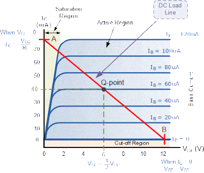

The depletion region between collector and base is bigger compared to that between base and emitter. So when you remove the BE junction battery, emitter can't inject electrons because of the reverse biased B-C junction.
To make the emitter inject electrons in the base, BE junction diode should be forward biased. As LvW said earlier, it is a voltage controlled current source.
You can see how collector current varies with base current (which is a function of B-E voltage).
