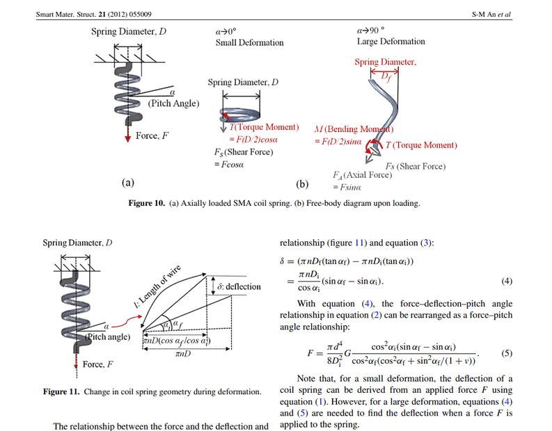

Please, see how the geometry of coil springs changes when extended:
https://www.researchgate.net/figure/Change-in-coil-spring-geometry-during-deformation_fig11_254499922
https://faraday.physics.utoronto.ca/PHY182S/WilberforcePendulum.pdf
Likes billyt_ and sophiecentaur

Thanks for this, did you take this from a textbook or a paper? Would you be able to let me know the name?
Thanks a lot!
Edit: Never mind I can see the link to the paper.
Likes Lnewqban
