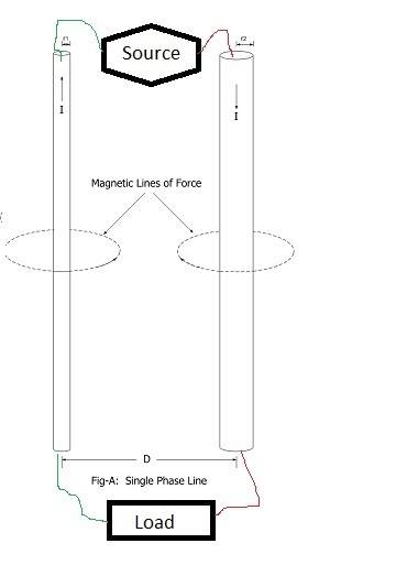

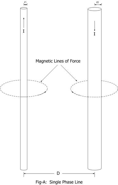

In power transmission where single phase power is transmitted in 2 wire AC system.
Now inductance is
The equation for inductance is then:
L = 2 X 10-7 In(De1/4/rx)
Why does inductance increase with increase in distance between conductors? When the spacing is increased, the air gap increases between conductors, so reluctance increases, so flux linkages decrease, so inductance must decrease, as L = flux linkages / current.
Why does inductance physically increase with increase in conductor spacing?
jaus tail said:
When the spacing is increased, the air gap increases between conductors, so reluctance increases, so flux linkages decrease(?),
i think you need to draw a picture.
what's formula fpr inductance of a loop of wire ?
Formula for inductance is L = flux linkages / current.
If distance is increased between the two conductors above, why does L increase? I think flux linkages would reduce because mutual flux would reduce.
L = 2 * 10-7 ln ( D / r / 0.7788)

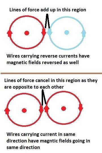

When you look at formula for inductance in a wire pair you usually see a caveat that one wire is assumed to be a source and the other a return. In that case flux cancels an amount. The closer the wires the more significantly flux cancels. That's why signal wires are often encased in a twisted pair, to reduce inductance.
For two wires carrying current in the same direction flux does not cancel, but currents are shared between two conductors so the overall value is reduced in the manner of parallel inductance. Proximity of the conductors does not have the same effect. Flux couples rather than cancels as wires become closer together.
Yes, even in the question in first post, the other conductor is return path for current in first conductor. So current in both conductors are opposite to each other.
but if you look at the center, then the magnetic lines of force are in same director for both conductors. Like both lines of flux are going into the screen like a cross.
so wouldn't the flux lines add each other instead of cancelling each other out?
I'm sorry but how are they cancelling. The scenario that i asked is just as the first picture. The one with red and blue flux line. the currents in conductors are flowing in opp directions.
And it says that the lines of force add in the region.
You're right with this image. I misread it when uploading. Sorry.
So the question remains same. Why does inductance increase with increase in spacing? In fact now if you look at image, it's clear the fluxes of the two lines are adding each other. So as distance between them increases, the flux reduces, so L must reduce.

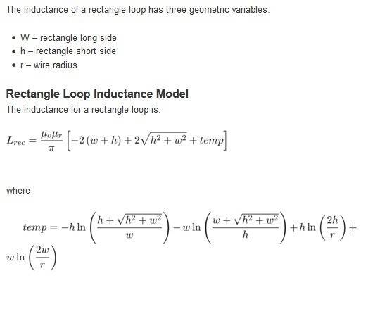

Formula for inductance of a flat loop is not so nice looking as for a solenoid and that's why most authors avoid it.
https://www.eeweb.com/toolbox/rectangle-loop-inductance

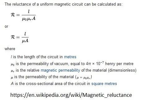

Flux equals mmf / reluctance. MMF depends directly on the current in the wire. Reluctance is the air gap reluctance. As distance increases the air gap would also increase between two conductors, so there should be less lines of flux. it's like a magnet will have strong force to objects near to it, than to objects away from it.
I saw the formula but i don't understand actually how can it be. if that's the case that inductance increases with distance then each transmission line will have infinite inductance as there are many many transmission lines all around the world. And its possible that some conductor will carry current in opposite direction.

reluctance ?

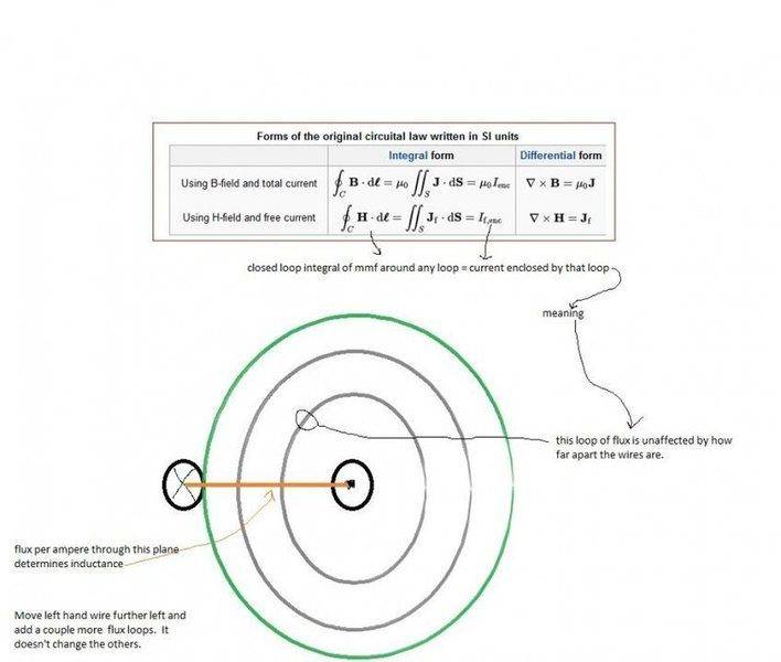

In your drawing, each wire is surrounded by concentric circles of flux. The wider the separation of the wires the more of those circles you can fit between them.

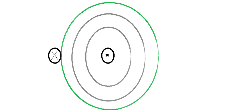

Draw an end view. Each wire is surrounded by concentric circles. The wider the space between the wires the more of those circles traverse that space.
Also realize that they're not really lines but a fluid-like continuum. We just represent the continuous field with lines whose closeness indicates intensity.

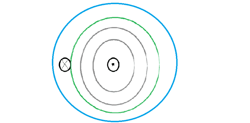

Draw two end views with one having separation twice the other. Do the circles near the wires get farther apart ? Or do you get more of them in the middle ? Why would the circles nearest each wire change any? Have you tried superposition yet ? What's the intensity contribution from each wire midway between them, and what is it 1/10th of the way between them?

Flux isn't intensity at any point, it's the integral of flux density over an area. When you add area by separating the wires you have a lot more points to tally up with your integral.

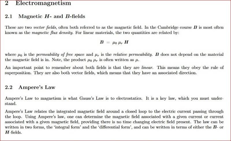

Start with Ampere's law.
http://mlg.eng.cam.ac.uk/mchutchon/electromagnetismeqns.pdf
Likes jaus tail

not all of that flux is linking or enclosing or cutting the left conductor.
the conducting loop encloses all the flux inside it.
At last - an end view !
Ever read "Flatland" ? https://www.amazon.com/dp/1508474184/?tag=pfamazon01-20
...Thinking in just two dimensions...
First, walk around any flux circle in your endview. Its intensity is determined by its length and the current it encircles. That's flux density.
Then , walk that orange line from end to end and tally the circles that cross it. That's flux.
Oh...i thought that as we separate the wires its the flux (concentric circles between wires) that will thin out instead of more circles coming in the picture because that's what happens in case of current through conductor if we increase cross section area.
So ideally the conductors must be as close to each other as possible to reduce L? if we neglect other factors as capacitance and physical limitations?
think about it. They're out there already because they aren't constrained to the area between the wires. Moving the wire fences in more of them. Unlike your current analogy because current is constrained to inside of the conductor.
that's why you see so much twisted pair. It minimizes the area encircled by the wires.

So the lines of flux are always there and as we add more space between the conductors there are more flux lines in the area so the flux linkages increase.
But then if we look at the blue flux. Then even this flux is encircling both the conductors. Why don't we take that into consideration? Like if we increase distance between conductors(move left conductor to the left), then blue flux will now go between them. But then otherwise the blue flux is also encircling the left conductor so why is L because of the blue flux ignored?
Like L because of mutual inductance, why must this L only involve flux that flows only between the conductors?
  • #31
because your blue flux line does not pass through the area enclosed by your current loop.
So it doesn't link the turn(s) of your inductor...
