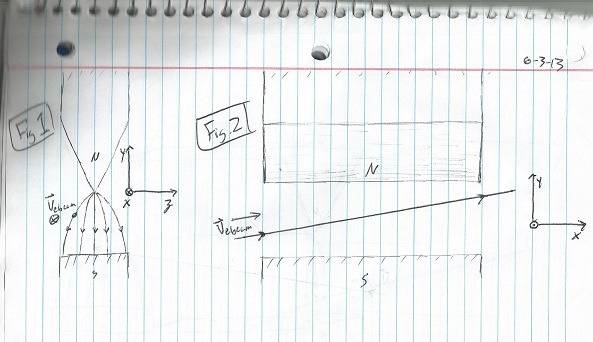

In the Stern Gerlach experiment it would seem that an electron beam moving at some velocity bisecting the upper magnet on a horizontal path would be radially accelerated perpendicular to the direction of motion.
I am assuming from Lenz's Law this can be corrected by increasing the Bf depending on the position and direction that the electron beam is fired into the experiment, here are two scenarios:
Figure 1 shows an electron beam fired horizontally along the positive x-axis slightly off center from the bisection of the experiment. As the beam is radially accelerated in the positive z direction the magnetic field increases counteracting this effect although it would seem there would still be some bending along the z axis.
Figure 2 is a representation of our beam now fired along the positive y/z plane bisecting our experiment. As the beam travels upward the Bf increases canceling the radial acceleration. This would seem like a more reasonable way to control the electron beam.
Is either of these two scenarios correct? some combination of the two? or am I just way out in left field?
I don't see the issue.
If you want to use an electron beam, you can use an electric field to cancel the force in z-direction. The magnetic field will always give a force in the same direction, changing its magnitude does not help.
Even if you don't use an electric field: so what? The interesting deflection happens in y-direction.

I am looking at the experiment from the standpoint of R=mv/qBf causing a radial acceleration perpendicular to that of motion from the two permanent magnets (like in a mass spectrometer).
I figured the only way to adjust for this acceleration is through Lenz's Law by increasing the Bf by altering the direction of the beam through the gradient of the field. It seems what you are saying is the experiment uses an external Ef that counteracts this acceleration as opposed to taking advantage of Lenz's Law, is that right?

No doubt, I just want to make sure I understand the idiosyncrasies before getting into the good stuff.

Why?
You would have to reverse the field polarity for that. And that is really bad for the main experiment.
That is possible.

Without either an external Ef/Bf or enough of a change in ∅m the electron beam would move out of the experiment due to radial acceleration perpendicular to the velocity of the beam. I think it is important to know how this acceleration is compensated for so I can better understand the experiment before diving into QM.

I don't understand why the field polarity would need to be reversed, wouldn't a large enough increase in ∅m be able to counteract the radial acceleration or is there something beyond Faraday and Lenz that I have yet to learn? If so please elaborate.

Well, the answer is actually very simple - don't use electron beams! In their original experiment, Stern and Gerlach used silver atoms. When you use electrons, there is even additional doubt cast upon the validity of using the classical equations of motion to describe their trajectories.
With silver atoms, most of your problems are solved, and then you can "dive into QM" and leave the electron problems to another time.
This is a quantum experiment anyway and should be treated quantum-mechanically. It's not very difficult (at least when using the usual approximations). A very nice treatment can be found in the paper

Electrons are not usually usd in the S-G experiment, because there is a spread in their deflection due to evXB deflection, that wipes out the magnetic moment deflection difference.
This is explained in Mott and Massey, "Theory of Atomic Collisions", but I think it has been forgotten by later books.

So if the electron beam is subjected to an increasing Bf by having the beam shot as shown in Figure 2 to counteract the evXB deflection this will 'wipe out' the magnetic moment of the electron? That is interesting, to make sure I understand what you are saying, by doing this the electron's behavior changes and will now act as predicted classically? Or does the pattern impacting the screen not resemble anything we would expect?
Or do you mean the magnetic field generated by the motion of the individual electrons interacting with others around it 'upsets' the final trajectory?
