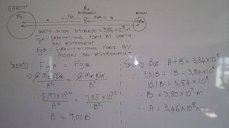

Can I just confirm as a simple minded Physical Science teacher that the answer will be 3.845 EXP 7 metres between null point and moon or 3.46 EXP 8 metres between null point and earth?
Hi allan19740813,
Welcome to Physics Forums.
Regardless of credentials, the rules here preclude simply providing answers or confirmation of what may be guesswork. Sorry about that. If you could show how you arrived at your results then we could comment on the work.
The solution that I have calculated and attached as a picture below is intended to act as a brainteaser for Grade 11 learners, so I have tried to simplify as much as possible. Please bear this in mind when commenting but most importantly I need to know if its correct
Yes, that looks fine.
