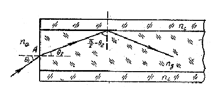

derive the angle of limitation sinθ=[(n2^2-n3^2)^1/2]/n1
n1 is the air out side of the fibre
n2 is inside of the fibre
n3 is the fibre wall
Snells Law:
n1sinθ1=n2sinθ2
I'm pretty stuck and don't really know where to go after getting the angles from geometry. I have pi/2-θ2 for the angle of reflection off of the optical wall. So I put this angle into Snells Law then just kind of get stuck.

First (for those of us unfamiliar with this topic), please describe the path of the light rays of interest. Better still, provide a diagram.
Snells Law:
n1sinθ1=n2sinθ2
Not quite.
When you have that corrected, use it at both the point of entry and at the point of internal reflection. (What is the minimum angle of incidence to get internal reflection? )
Connect the two using cos2 = 1 - sin2.
Snells Law: n1Sin(θi)=n2Sin(θt) where t is the transmitted and i is the incident ray and their angles are measured relative to the normal of the surface.

Ok I think I've got it,
[tex]\sin\theta[/tex]
[tex]n_1\sin\theta_i=n_2\sin\theta_t[/tex]
Known that the critical angle is [tex]\arcsin(\frac{n_2}{n_1})[/tex]
[tex]\arcsin(n3/n2)=\frac{\pi}{2}-\theta_2[/tex]
[tex]\theta_2=\frac{pi}{2}-\arcsin(\frac{n3}{n2})[/tex]
[tex]n_1\sin(\theta_i)=n_2\sin(\theta_2)\\
n_1\sin(\theta_i)=n_2\sin(\frac{pi}{2}-\arcsin(\frac{n_3}{n_2}))\\[/tex]
use the identity [tex]\sin(A-B)=sinAcosB-cosAsinB[/tex]
[tex]
n_1\sin(\theta_i)=n_2\sin(\frac{pi}{2})\cos(\arcsin(\frac{n3}{n2}))[/tex]
use the identity [tex] \cos(\arcsin(x))=(1-x^2)^\frac{1}{2}\\
n_1\sin(\theta_i)=n_2(1-(\frac{n_3}{n_2})^2)^\frac{1}{2}\\
\sin(\theta_i)=\frac{n_2}{n_1}(1-(\frac{n_3}{n_2})^2)^\frac{1}{2}\\
\sin(\theta_i)=\frac{1}{n_1}((n_2)^2-(n_3)^2)^\frac{1}{2}[/tex]
Thanks for your help haruspex!
Converted to LaTeX for easier reading :wink:
##n_1\sin(\theta_i)=n_2\sin(\theta_t)##
Known that the critical angle is ##\arcsin(\frac{n_2}{n_1})##[general case]
so ##\arcsin(\frac{n_3}{n_2})=\frac{\pi}{2}-\theta_2##
##\theta_2=\frac{pi}{2}-\arcsin(n_3/n_2)##
##n_1\sin(\theta_i)=n_2\sin(\theta_2)##
##n_1\sin(\theta_i)=n_2\sin(\frac{\pi}{2}-\arcsin(\frac{n_3}{n_2}))##
use the identity ##\sin(A-B)####=####sinAcosB-cosAsinB##
##n_1\sin(\theta_i)=n_2\sin\frac{\pi}{2}\cos(\arcsin(\frac{n_3}{n_2})##
use the identity ##\cos(\arcsin(x))=(1-x^2)^\frac{1}{2}##
##n_1\sin(\theta_i)=n_2(1-(\frac{n_3}{n_2})^2)##
##\sin(\theta_i)=\frac{n_2}{n_1}*(1-(\frac{n_3}{n_2})^2)##
##\sin(\theta_i)=\frac{1}{n_1}*((n_2)^2-(n_3)^2)^\frac{1}{2}##
