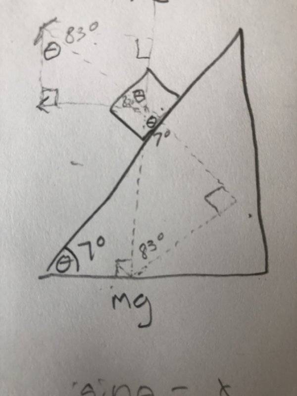

You have a weekend job selecting speed limit signs to put at road curves. The speed limit is determined by the radius of the curve and the bank angle. For a turn of radius 400 m and a 7.0 degree bank angle, what speed limit should you post so that a car traveling at that speed negotiates the turn successfully even when the road is wet and slick?
F = ma
a = v^2/r
245796
So here is what is going on in my mind:
We have a turn that is 400m away from the center of the turn. The faster the car goes, the harder it is for it to maintain its radius.
We have a component of the normal force that points towards the center, and static friction which does the same.
I can't identify a force that goes in the opposite direction.
As the car drives too fast, it overcomes the static force.
I need help at this point. Thank you

I have the normal force = mgcos(theta). But the key says its mg/cos(theta). How can this be correct?
I have the horizontal force equal to mgcos(theta)sin(theta) = mV^2/ 400
I got a velocity of about 22 m/s
But once again, I'm not sure if I expressed the normal force correctly
The magnitude of the normal force should be less than the gravitational force, making mg the hypotenuse.

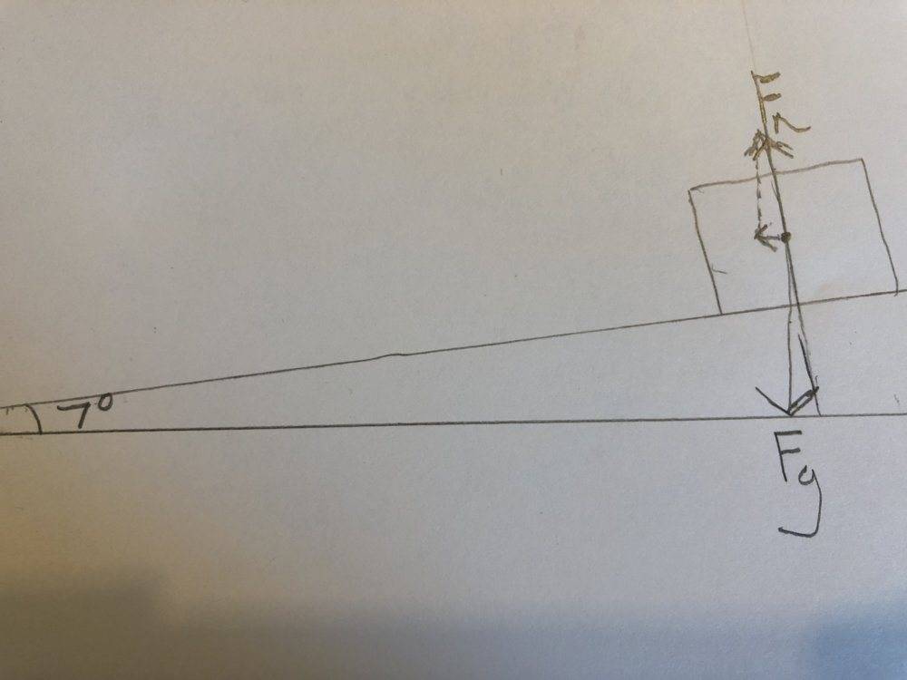

Let’s see your free body diagram showing the forces N and mg acting on the car.
The only two forces are N which is perpendicular to the ramp, and mg which is perpendicular to the ground
245819
Good. Now please next express the force balance in the vertical direction.
Likes Jaccobtw
Σ F(y) = Ncos(theta) - mg = 0
The vertical component of the normal force minus mg = 0
why doesn't using trig work on the bottom triangle, where mg is the hypotenuse, to find the normal force?
Jaccobtw said:
why doesn't using trig work on the bottom triangle where mg is the hypotenuse to find the normal force?
For the typical problem where a block slides up or down an inclined plane, the acceleration is along the plane. So, there is no component of acceleration perpendicular to the plane. So, the components of the forces that are perpendicular to the plane add to zero. This leads to N = mgcosθ if N and mg are the only forces.
But in this problem, the acceleration direction is not parallel to the plane. So, there is a nonzero component of acceleration perpendicular to the plane. The components of the forces that are perpendicular to the plane do not add to zero. You no longer get N = mgcosθ. The force components that are vertical add to zero, as in your post #9.

So the normal force is actually greater than gravity...When usually its the other way around... Is this correct?
Yes. Avoid carrying over a formula that is valid in a specific situation to a different situation. Use your free-body diagram along with what you know about the direction of the acceleration to derive what you need.

Because the resulting acceleration has a component normal to the plane. If you resolve forces in that direction you get ##N-mg\cos(\theta)=ma\sin(\theta)##. That was why I asked about the direction of a in post #4.
Since the net force is to be horizontal, the normal force must not only balance gravity by itself but also provide the centripetal force.
