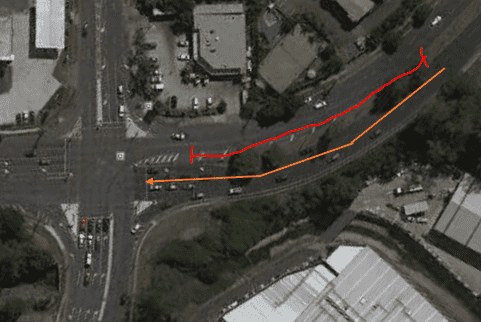

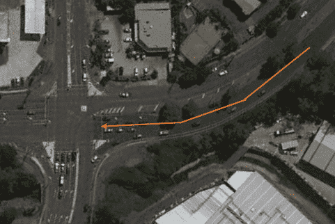

I will make it clear to you. Here is a picture of the road way the car will be coming down.
the orange line indicates where the vehicle will come from.
The red line indicates where the hill will be declined.
The car will be going down the hill at an angle of 3.65 degrees of depression while it is turning on a radius of 156.3m. How would I find the acceleration and/or the minimum braking distance if the car was traveling at 60 km/hr?
The one does not translate directly into the other. As BvU posted, if the car is moving at a given speed then the slope does not affect the acceleration (the bend does). But the slope does affect the braking force available.
It is unclear whether the road is an arc on a sloping plane, in which case the slope will decrease as it tracks around the curve, or follows a helix, like a helter skelter, making the slope constant.
Finding the minimum braking distance is quite complicated. As the car slows down, the radial acceleration decreases, leaving more braking force available for slowing.
So please state the problem exactly:
- is it a sloping plane or a helix;
- do you need to find the minimum braking distance, the maximum initial deceleration, or... what?
Quick back of the envelope calculation suggest the car should have no problem stopping. I estimated it should be able to stop in under a third of the available stopping distance.
It is in a helix. and I need a formula for which i will be able to plot in certain initial speeds of the car to find the minimum braking distance.
