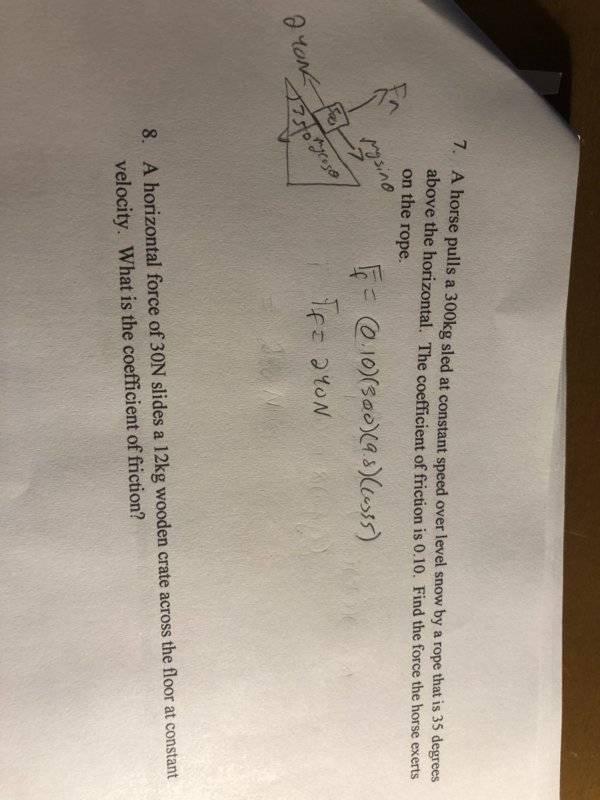

A horse pulls a 300kg sled at constant speed over level snow by a rope that is 35 degrees above the horizontal. The coefficient of friction is 0.10. Find the force the horse exerts on the rope.
F = nukFn
f=ma
mgsin Ѳ= fx
mgcos Ѳ=fy
I tried to find the force of friction using the the coefficient of kinetic friction with the equation F=nukmgcos Ѳ. Then I made the force of friction equal to the force of pull. I don't know what I'm doing wrong as I'm getting the wrong answer. I have attached a picture of my work.
Your diagram is wrong. (And your title.)
What is at 35 degrees?
The picture of your work is not oriented properly.
Both the title of your question and your diagram indicate you are using the physics applicable to an inclined plane. But the question states "A horse pulls a 300kg sled at constant speed over level snow"
