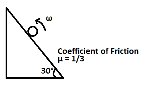

A cyclinder of mass m and radius r is rotated about its axis by an angular velocity ω and then lowered gently on an inclined plane as shown in figure. Then:
(a) It will start going upward.
(b) It will first go up and then downward.
(c) It will go downward just after it is lowered.
(d) It can never go upward.

You do not need torques to solve this problem. All you need to determine is the motion of the centre of mass. The motion of the centre of mass is determined by taking into account all the external forces that act on the system.
What are they?
The forces that act on the cyclinder are
- Normal due to Incline
- Weight of the cyclinder
- Friction by virtue of its rotation
But how do we combine them and get it where the body will move thereafter?

Yes, those are correct forces. I recommend that you write Newton's second law in the components parallel and perpendicular to the incline.
Parallel to incline
[tex]mgsin(30°)\ -\ f_s\ =\ ma[/tex]
Perpendicular to incline
[tex]N\ =\ mgcos30° [/tex]
Then with friction
[tex]f_s\ <=\ μN\\
\implies\ f_s\ <=\ μmgcos30°[/tex]
And what acceleration does that give you?
Is it possible that $$ \mu = \sqrt {\frac 1 3} $$?
Yes,
[tex]\mu\ =\ \frac{1}{\sqrt{3}}[/tex]
It gives zero acceleration.
But what does this infer ?
What is the initial velocity of the cylinder's centre of mass when it is lowered onto the incline?
There is no initial velocity of the centre of mass initially, it only has initial angular velocity.
So, if the centre of mass is initially stationary, and then the acceleration is zero, does it move anywhere?

You did, but implicitly. Because of the rotation, the force of kinetic friction is up the incline.
The conditions we took would be the same as if the one when someone would simply keep a non-rotating cyclinder over the incline
No, that is not true. A non-rotating cylinder would begin to roll down immediately.

I have thought about this more, and I now think you original assessment was correct. What happens here is that while the cylinder is slipping, it will be accelerating up the incline, while its rotational motion will be slowing down. At some point that will cause it to stop slipping, at which point it will begin to accelerate down, while still rolling up for a while. Then it will come to a complete stop and then will roll down.
My mistake was in not realising that slipping will have to stop before angular velocity becomes zero.

Ok let me sum up.
- The net acceleration of the center of mass is zero, therefore body doesn't move.
- Every point on the cyclinder has velocity by virtue of its rotational motion, except the center of mass as its not moving.
- The acceleration on the point of contact is due to friction as the point of contact has relative motion with the surface in contact.
This solves the problem. I just hope its correct.

This one is not correct. The acceleration on the point of contact is not only due to friction. Imagine a cylinder suspended on a bearing and not touching anything except the bearing itself, about which it can rotate freely. When it rotate, all points of the cylinder that are not on the axis of rotate experience acceleration.
Oh, right, the acceleration is also caused due to the centripetal force(rotation). Acceleration because of change of direction of velocity.
So the acceleration of all the points is due to centripetal force, and the acceleration of the point of contact is due to centripetal as well as frictional force.

Hello phoenixXL
Let P be any point on the rotating body with C as the contact point .
##\vec{a}_{P} = \vec{a}_{P,COM} + \vec{a}_{COM}##
Acceleration of COM is given by
##\vec{a}_{COM} = \frac{\vec{F}_{net}}{M}##
Acceleration of the point P with respect to COM is
##\vec{a}_{P,COM} = \vec{a}_{tangential} + \vec{a}_{radial} ##
where ##\vec{a}_{tangential} = \alpha R##
and ##\vec{a}_{radial} = \frac{v^2}{R}##
So, ##\vec{a}_{P} = \vec{a}_{tangential} + \vec{a}_{radial} + \vec{a}_{COM}##
If the body is rolling without slipping ,then for the contact point C , ## \vec{a}_{tangential} = -\vec{a}_{COM}##
So the total acceleration of point C is given by ##\vec{a}_{C} = \vec{a}_{radial}##
Hope that helps

Thank you Tanya, its crystal clear and lucid now. Thanks a lot :smile:
