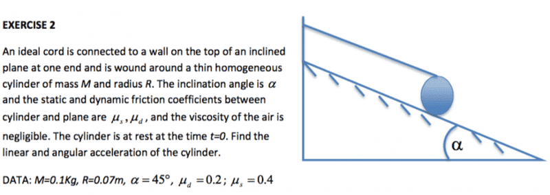

Why is Static Friction Oriented Downwards on an Inclined Plane?
In summary, the problem involves a cord connecting a wall to a cylinder on an inclined plane. The cylinder has a mass of M and a radius of R and is at rest at t=0. The inclination angle is ϑ and the static and dynamic friction coefficients between cylinder and plane are μs and μd. The goal is to find the linear and angular acceleration of the cylinder. There is some confusion about the direction of static friction, but it is determined that the cylinder will roll down the slope and the direction of friction is opposite the motion. The direction of static friction can be determined by checking if it is enough to resist the motion.
DottZakapa
239
An ideal cord is connected to a wall on the top of an inclined plane at one end and is wound around a thin homogeneous cylinder of mass M and radius R. The inclination angle is ϑ and the static and dynamic friction coefficients between cylinder and plane are μs, μd , and the viscosity of the air is
negligible. The cylinder is at rest at the time t=0. Find the linear and angular acceleration of the cylinder.
- I didn't really get why the static friction is oriented downwards along the inclined.

You right, i didn't make my self clear! Sorry about.
Basically i need to know the direction of the friction in order to evaluate the torque
  • exercise 2.pdf

What you see in the attachment is all I have, I also got the solution in which uses the static friction going down, that I don't get why.
In my view at time t=0 is all at rest, hence you check if the static situation will hold for ever or not; if the cord is ideal then it has no elasticity (extension ) so i think that the cord contact point with the cylinder will always be at rest, seen that hasn't been specified any other kind of actions.
As I am writing I've just realized why the friction goes down.
If the contact point of the cylinder with the plane slides, the only direction of the sliding will be downwards because the cord holds the cylinder from the top, it then follows that the direction of dynamic friction is opposite the motion, in conclusion if the system is at rest the direction of static friction is the opposite.
Some times just speaking helps figure out things :)

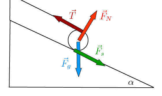

This is what you're claiming for the static case:
If these force vectors are correct, I just cannot see how that cylinder is going to roll down the inclined plane without "slipping". I also cannot see how this picture could ever possibly imply that the ball would remain stationary if ##|\vec{T}| = |\vec{F}_s|##. Please help me see what I'm missing. When I take the sum of the cross products to get the net torque, ##\vec{\tau}^{net} = \vec{r}_1 \times \vec{T} + \vec{r}_2 \times \vec{F}_s##, I don't see any way to arrive at a zero net torque because the two cross products result in vectors with equivalent directions.
Edit: ##\vec{r}_1## points from the cylinder's radial center to the point at which the cord is no longer in contact with the cylinder. ##\vec{r}_2## points from the radial center of the cylinder to the line along which the cylinder is in contact with the inclined plane.

DottZakapa has come to the conclusion that, if the situation calls for a static frictional force, it is directed down the plane as I tried to illustrate in my previous post. This doesn't make sense to me. I could see how this would be the case in the absence of the rope, but not with its presence. Did my illustration not display properly in my previous post?
  • #35
[ ATTACH=full]85184[/ATTACH]
Yes. You are correct.
With the forces in the directions indicated there is no way for the torque on the ball to be zero. It will have angular acceleration causing rotation in a counter-clockwise sense.
(Sorry. I was a bit late in sorting out the issues! I see them now.)
