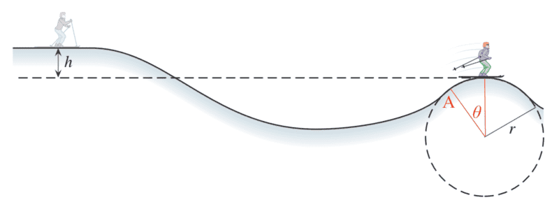

A skier starts from rest at the top of a hill. The skier coasts down the hill and up a second hill, as the drawing illustrates. The crest of the second hill is circular, with a radius of r = 36 m. Neglect friction and air resistance. What must be the height h of the first hill so that the skier just loses contact with the snow at the crest of the second hill?

This is problem 49 in chapter 6 of "Physics - 9th edition". A similar question was asked here several years ago (although with a different height).
The figure is below. I added point A and angle \theta.
The solution is pretty easy. For the purpose of my discussion I'm assuming that the height is zero at the "center" of the rightmost hill, and consider a generic point A on such hill, instead of its crest. The radius going through A forms an angle \theta with the vertical direction. The answer to the question can be obtained by setting \theta =0 in the solution.
The condition for losing contact at A is that the normal force there is null, which means that the centrifugal force equals the projection of the weight along the radial direction. This gives v^2 = g r \cos \theta.
Conservation of total mechanical energy requires that 2 g h_0 =2 g r \cos \theta + v^2, where h_0 is the height of the leftmost hill wrt the center of the leftmost hill. Substituting the first equation into the second one we get
h_0 = \frac{3}{2} r \cos \theta
Since the height of point A is r \cos \theta, the starting point should be
h = \frac{r}{2} \cos \theta
above A for the skier to lose contact at A.
If \theta=0 one gets h = r/2 = 18\, {\rm m}, which is the solution given by the book.
The problem in my opinion is that h is a decreasing function of \theta. This means that the height for losing contact at an angle \theta>0 is less than 18\, {\rm m}. This in turn means that if the first hill is 18\, {\rm m} above the second, the skier will definitely lose contact before reaching the crest of the second hill.
So, if I'm correct, the proposed exercise is not very hard, and in a way it's nice, but it does not make a lot of sense.

I'm actually not very clear on what is meant here by "crest of the hill". I interpreted that as "the uppermost portion of the hill", not just its very top. That is, I assumed that the (section of the) top of the hill can be described as a circular arc, which is what the figure suggests.
In that case, the skier will jump at the starting point of that circular arc (at the start of the range, if I get your meaning for this word right).
In a situation like the one depicted in the figure (which is not so unrealistic for a ski run, by the way) the skier will jump well below (and before) the top of the hill.

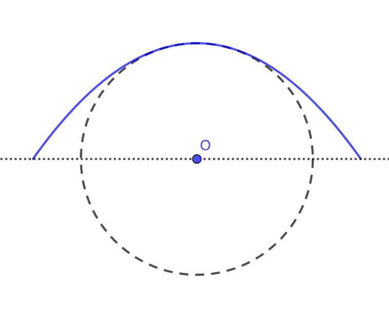

I did some quick calculations assuming that the top of hill is described by the function
y=-\frac{x^2}{2R}+R
for -x_0\leq x\leq x_0, where R is the radius of curvature of such shape at x=0. If my calculations are right and that was a ballistic trajectory, the velocity at \pm x_0 would be such that
v_0^2=2Rg \left(1+\frac{x_0^2}{R^2}\right)
On the other hand, for the velocity at x=0 on the hill to be v^2=g R, it should be v_0^2=g R+g\frac{x_0^2}{R} at -x_0.
Thus the condition to be met appears to be
g R+g\frac{x_0^2}{R}< 2Rg \left(1+\frac{x_0^2}{R^2}\right)=2 \left(gR+g\frac{x_0^2}{R}\right)
which is always true.
After all this is also apparent from the expression of v_0.
At this point (even later in the night) it appears that with a parabolic hill, either the skier is always in contact with the snow (including at the top of the hill), or he is never in contact with it.
So i still cannot figure out the shape of the hill...

ok... the dirtbike jumps before the top... That is also my intuition. But I think the hills are not shaped for avoiding that effect.
I am wondering whether it's (theoretically) possible to build a hill where the motorbike would lose contact at the topmost point only, like the skier in the problem.
One possibility is perhaps to add a x^4 term in the function above. This should not change the curvature radius at the top of the hill, but changes its shape.
