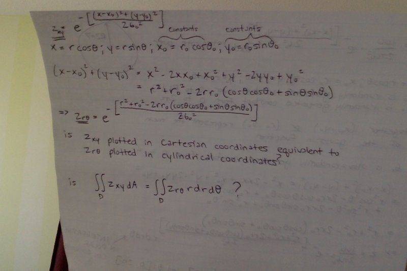

I have a 2D Gaussian:
## f(x,y) = e^{-[(x-x_o)^2 + (y-y_o)^2]/(2*{sigma}^2)}##
which I converted into polar coordinates and got:
## g(r,θ) = e^{-[r^2 + r_o^2 - 2*r*r_o(cos(θ)cos(θ_o) + sin(θ)sin(θ_o))]/({2*{sigma}^2})} ##
The proof for how this was done is in the attached file, and it would be great if someone could verify my steps in case I messed up somewhere (although I have inputted values and it seems to work). I have plotted the functions, and they do seem comparable by visual inspection, too.
The characteristics of the functions (including ## sigma_o##) are manually specified by me, so the values for ##x_o##, ##y_o## match up with ##r_o## and ##θ_o##. Now, when I integrate these functions over the same regions, I don't always get the same answers. For example, when ##r = 0## or ##θ = 0##, I do get the same answers, but when ##θ \neq 0##, then the answers are slightly off. I have been trying to search for where I'm going wrong, and it may be completely obvious (likely associated with the sine and cosine terms), but I'm just not seeing it. The fact that the values from completing the integration on Python (in polar coordinates) and WolframAlpha (in cartesian coordinates) are relatively similar for the cases where ##θ \neq 0## seems a little odd to me. If anyone has any thoughts, it would be greatly appreciated!

I've also been trying points in both f and g to see if they correspond, and they seem to work. For example, if:
##sigma = 1##
##x_o = 1##
##y_o = 2##
then ## f(1,1) = e^{-0.5} ##
This also corresponds to:
##r_o = \sqrt{26} ##
##θ_o = ~1.107##
then ##g(\sqrt{2},pi/4) = e^{-0.5}##
I am leaning towards there being an error in my actual integration, but do you see any?
If I use these values for the code:
##sigma0 = 5##
##r0 = 2**0.5##
##theta0 = 1.75*np.pi##
Then the value for the integral I get is: 1.33556147e+01
When I do this in WolframAlpha, I get: 12.7035
Any advice is welcome!

Here is the WolframAlpha calculation in cartesian coordinates that should correspond to my polar coordinate integration in Python.
I am not understanding why you have an imaginary part of your cartesian integral. You probably need to break that integral into two parts.
for x = 0 to 4 and for x=4 to 7.
Likes DEvens and MathewsMD
You're right. Let me check that out. Complete oversight by me haha. Thank you!
It's a little difficult to understand what exactly you are integrating. It seems like you are integrating from ##r## 4 to 7, and ##\theta## from 0 to pi/2. So this is some chunk of a 2-D Gaussian. Without checking if you have done that correctly, you are worried that when you change ##r_0## and ##\theta_0## that you get slightly different values.
Well, yes. You are integrating a different part of the Gaussian when you do that. Or so it seems.
Also, I want to pile on what RUber asked. What is the integral you fed to Wolfram? What's with the square roots in the integrand?
And it turns out my code is correct, I just messed up my integral! Sweet! Thank you for catching my mistake!
