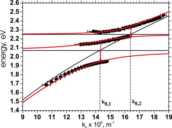

The matrix is pretty standard in hybrid polaritonics as well as the 3-oscillator dispersion.
Determining-the-Rabi-energies-by-the-coupled-oscillator-model-Dispersion-relation-of-the.jpg
Taken from:
Strong coupling between surface plasmon polaritons and Sulforhodamine 101 dye
  • March 2012
  • Nanoscale Research Letters 7(1):191
  • DOI:
  • 10.1186/1556-276X-7-191
  • Source
  • https://www.researchgate.net/deref/http%3A%2F%2Fwww.ncbi.nlm.nih.gov%2Fpubmed%2F22429311

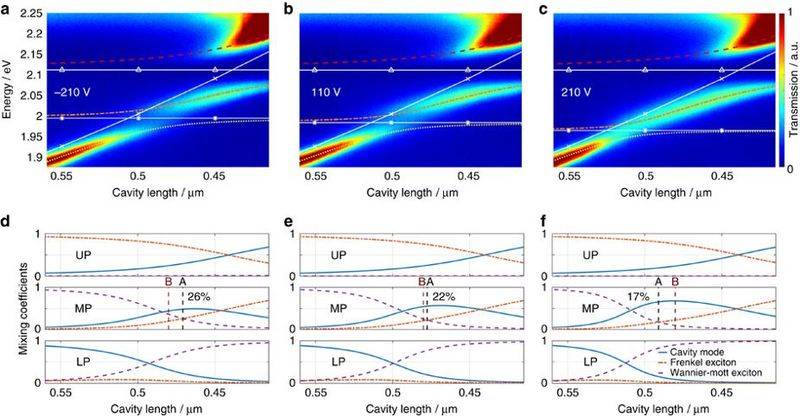

That is puzzling. You want to calculate the polariton dispersion for two different excitons coupling to a cavity mode, but post a reference for surface plasmons, which have a different dispersion. Most likely you are assuming wrong coupling constants or an incorrect dispersion for the bare particles.
It will be hard to help you, unless you post the exact bare particle dispersions and off-diagonal matrix elements you assume. Is your cavity dispersion parabolic with an effective mass? What is the effective mass you assume? What are the off-diagonal elements? What does your dispersion look like now?

Assuming you are not interested in linewidths (imaginary part) at the moment, you are doing it right. This will give you the correct results. A quick check gave me the correct dispersions.
Did you check that:
- your convention in the cos-term is right (degree or radians)
- hat you remember to convert back to the energies? The roots you calculate this way are for the [itex]\lambda_n[/itex] in the transformed cubic, which is usually called t and not equivalent to your initial [itex]\lambda_n[/itex]. You get back to the energy by calculating [itex]E_i=t_i-\frac{b}{3a}[/itex]
Thanks! I'll check. Could you tell me what you used for your micro cavity energy?
I just used simple numbers, where I know that the numbers will not create a mess.
The x-value (cavity length, k-value, whatever) goes from 1 to 100. In this range, Ec goes from -50 to 50. Ef=-10. Ew=10. F^2=W^2=10.
Of course these numbers are unphysical, but it is easy to go to meaningful numbers once the equations work well.
