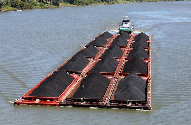

Hard to see that working on the Mississippi, and a standard arrangement is one tugboat to 15 barges:
Coal-carrying barges move in tows of fifteen to forty barges, pulled by a single towboat of 2,000 to 10,000 hp. A "jumbo"-size barge carries 1,800 tons (1,633 tonnes) of coal, so a large tow can move 72,000 tons (65,304 tonnes) of coal, as much as five unit trains. These large volumes result in significant economies of scale. Barge rates can run (on a cost-per-mile or cost-per-kilometer basis) a quarter or less of rail rates.
https://www.encyclopedia.com/environment/encyclopedias-almanacs-transcripts-and-maps/coal-transportation-and-storage#:~:text=Coal%2Dcarrying%20barges%20move%20in,much%20as%20five%20unit%20trains.
