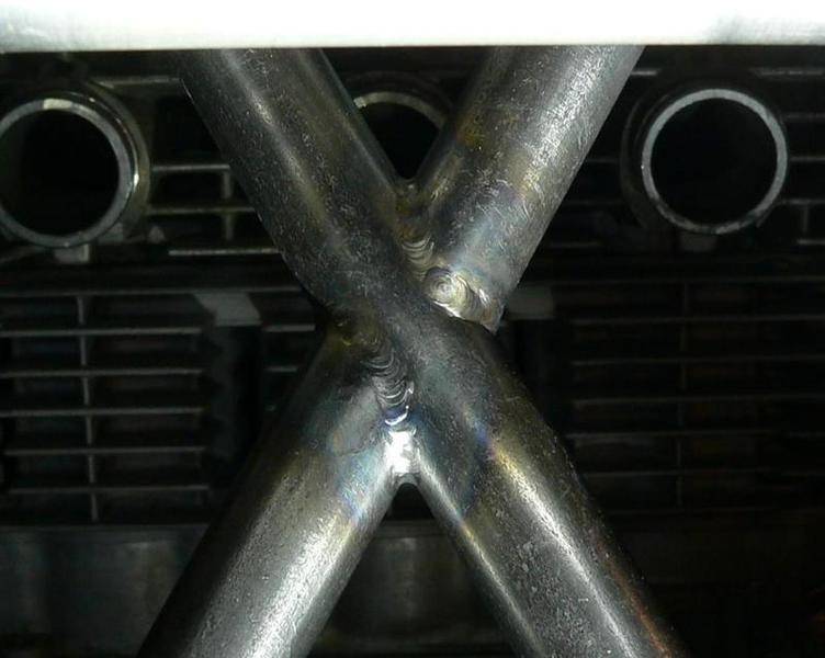

Hello,
Looking for some advice on increasing bending stiffness of a mild steel 1" x 0.065" round tube.
This is for a motorcycle frame and clearance is an issue. There is a fuel tank above and the engine below this top tube (two running parallel) that I wanted to reinforce against bending.
Tried internet searches on stiffness and learned a little about beams and elastic modulus.
So I came up with this...
The segment that needs to be braced is about 12" long from the rear cross brace in red to where the boxed section ends on the top tubes.
Thanks much in advance!
It's not clear why you think these particular tubes need reinforcement.
With such thin walls in these tubes, I would be very careful about trying to weld anything to the outside along the length of the tube. You might weaken the existing tube if the welding isn't done correctly.

the welding is the easy part. the physics is the stuff I need help with. :)
i've already tig welded the rear crossmember in place.
and I feel comfortable making a safe weld. Your caution however I do take very seriously. Thanks.

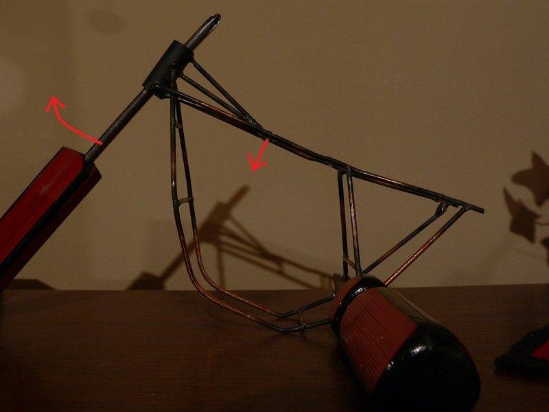

I also built this to help visualize the stress through the frame.
Looks like to me the deficiency in the frame design is that forces through the head stock are transmitted only part way down the top tubes.
Triangulating the frame isn't really possible with the tank and engine in place. (BTW, the bike is a yamaha xs750)
The idea is to make the path from the head tube to the swingarm mounts more stiff. (sorry if this is the wrong terminology)
