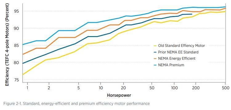

Integral horsepower induction motors are subject to efficiency standards, and that efficiency is a function of motor size. Good search term to learn more is induction motor efficiency standards. This chart is from one of the hits: https://www.energy.gov/sites/prod/files/2014/04/f15/amo_motors_handbook_web.pdf.

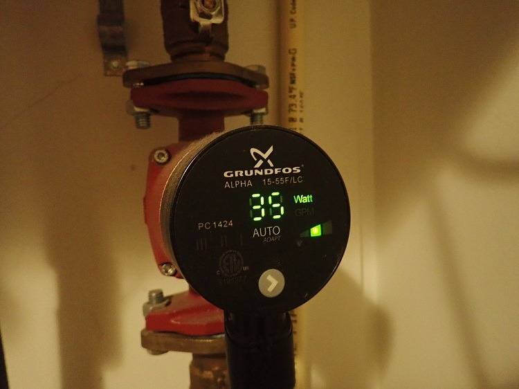

These motors are already efficient enough that huge increases are just not possible. Smaller motors have more room for improvement. ECM motors (search the term) have been commonly available for about 30 years. They are popular in HVAC systems for both pumps and blower motors. This pump in my home heating system varies its speed depending on whether one, two, or all three zones are running. The photo was taken with two zones running:
Turntide has a new spin on 30 year old technology. Their design is a switched reluctance motor, Switched reluctance is an old design that became practical with the development of modern electronics. It competes with the permanent magnet rotor motor design in the pump shown above, and it competes with vector drive induction motors.
Definitely a noticeable 'scale up' in efficiency wrt Hp of the motor.
