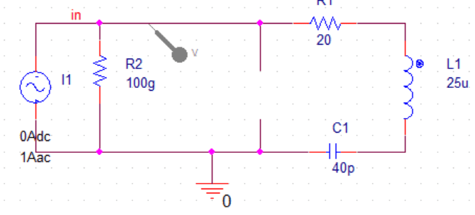

I would like to increase the frequency range for which the impedance of my system is 50 ohms in order to reduce power losses due to impedance mismatch.
Hello,
Some trouble came up today with designing a 50 ohm system for a wireless powering project. I'd like to increase the frequency range for which my system impedance is 50 ohms in order to reduce power losses due to mismatch. I've simulated two RLC circuits in OrCAD SPICE to demonstrate my issue.

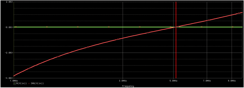

In one circuit, I simply simulated the RLC circuit by itself and measured the impedance. I did so by applying a 1A constant current and measuring the voltage. We know that Z=V/I, so the voltage I measure is proportional to impedance. In this circuit, I see what I expect to see: a constant real component of resistance (green) and a reactance (red) that crosses zero at the resonant frequency.

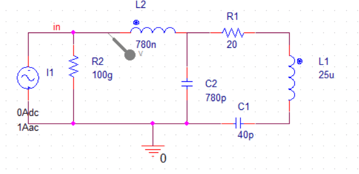

In the second circuit, I used an L network to match the impedance at resonance to 50 ohms.

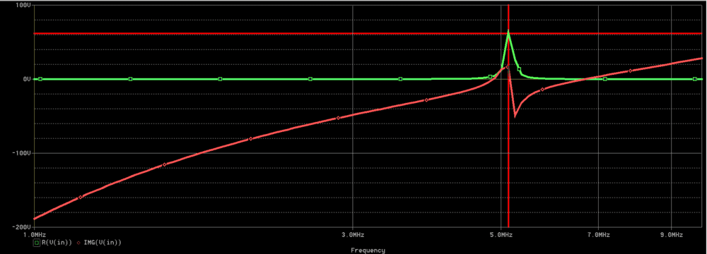

The issue here is that my system impedance is only 50 ohms at the very peak. A very small mismatch in frequency can cause a very large mismatch in system impedance which can result in very large power losses.
I tried googling some terms to see if a topology exists to remedy such a problem, but I didn't find one. I'm basically looking for a "bandpass" transfer function where I have a 50 ohm pass band. I'm not looking to be spoon-fed the answer if a common one exists, but rather, I need some advice on where to start. Any references (textbooks, papers, articles, etc...) would be greatly appreciated. If not, your practical experience would be greatly beneficial. Do most RF engineers pick an exact system frequency and just stick to that?
Typical way for to increase bandwidth of 50 Ohm parallel resonance circuit is to have impedance at resonance at about 100 Ohm.
You should search for “broadband impedance match.” You are basically looking for a complex network of Ls, Cs and, if you are at high frequency, transmission line segments, that wrap the impedance around and around 50 ohms on the Smith chart. It’s not easy.

Added to berkeman's post, I'd say your description is very confusing. You want to match to 50 ohms but then its 20 ohms instead, and the coil is 25 mm in diameter except when it's 2 mm? You're all over the place.
You are trying to operate at too high a frequency for a 25 uH coil, so the inter-turn parasitic capacitance and stray capacitance in the leads is throwing you off. Increasing C to maybe 1 nF or more will help. As far as geometry is concerned, a solenoid loses compared to a flat pancake coil. (Can you see why?) I second the advice to do some research (and some EM analysis!).

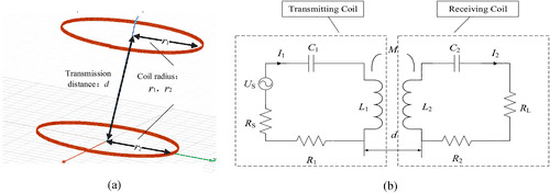

Have a look at this paper, which is one of the first on the Google hit list that I linked to:
https://aip.scitation.org/doi/full/10.1063/1.5007276
The math is pretty accessible, and there is pretty good information in it for geometries similar to what you are implementing. It looks like they are assuming a 50 Ohm source impedance Rs for the power source, but they are minimizing other resistances (like wire resistance). They explore optimizing the power transfer based on resonant frequencies, coil separation distance and load resistance, for example.
You might also try altering the source impedance Rs of the input power source in their equations, to see if it should be something different because of the loosely-coupled Tx and Rx coils.
