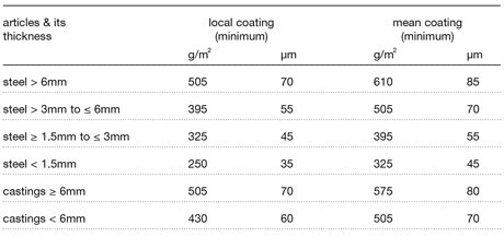

tech99 said:
The zinc was 3 thousands of an inch. That is a good spec.

tech99 said:
That's a useful link. The document linked offers other important points other than coating thickness.
In addition to steel thickness, the composition of the steel alloy itself is also relevant. Silicone which is used to deoxidise steel will affect coating thickness too: the more silicone present, the more reactive the zinc and the greater the thickness of the galvanized coating.
How this microscopic coating then weathers is predictable but complex and fluctuates with atmospheric conditions. In most dry inland situations this can be infinitesimally slow, less than 1 micron per year, and unlike other coatings, a galvanized coating deteriorates in a linear fashion. As long as the environment remains stable, case studies show that the coating throws up no unpleasant surprises and can be relied upon.
Moreover, in the UK and Ireland, as sulphur dioxide levels have fallen, corrosion protection has been extended. It does indeed pay to know your microns.
EN ISO 1461: coating minimum masses/ thickness on articles that are not centrifuged
Centrifuging removes excess liquid zinc and reduces thickness.
