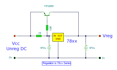

I'm looking to draw about 6A. I have an LM338 regulator that can supply up to 5A. Searching the internet I came across this schematic,
So basically when the 1R resistor drops 0.6V then the transistor conducts the remainder of the current. I calculated my own values for those two resistors. Was wondering if my values are fine,
I want 3A to pass through the regulator, so I got R1 to be,
R1 = 0.6V / 3A = 0.2 ohm
PR1 = 3^2 * 0.2 = 1.8 W

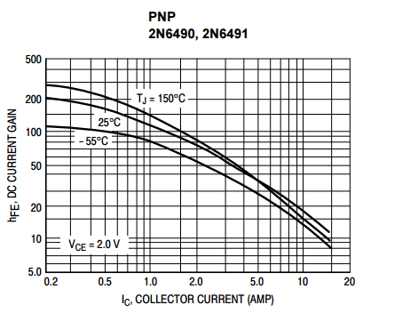

The remaining 3A can pass through the transistor, using the 2N6491 PNP transistor, this one
http://www.onsemi.com/pub/Collateral/2N6487-D.PDF
From the datasheet hfe at 3A is 50
So, Ib = Ic/hfe = 3A / 50 = 0.06 A
Vb = Vin - 0.6 (Vin = input voltage to the regulator)
= 13.85 - 0.6 = 13.25 V
Rb = Vb/Ib
= 13.25 / 0.06 = 221 ohm

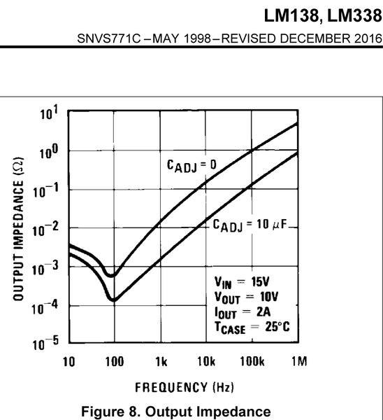

Depends on the usage. For instance at the upper end of the audio frequencies, the output impedance of the regulator is equivalent to a 50uF cap. That's not much for a 6A supply. edit: see post two down. end edit
Averagesupernova said:
The reason I wonder about it being to much capacitance is the amount of current draw on power up. The 3 terminal regulator on its own is quite likely able to handle a very very large capacitance. However, when we have the current boost transistor added on and we power up, it is like a short circuit until that cap on the output is charged. I know from experience that this type of current boost configuration WILL smoke when its output is shorted.
Use current limiting as shown in https://www.fairchildsemi.com/datasheets/LM/LM7805.pdf, pg 20, fig 14. It uses one transistor and one resistor.
I did not understand.. Or you might be talking for example about a leaky audio amp which requires supply bypass caps?
You're right , I'm off by a factor of two. The 50uF should have been 120uF.
If you look at the output impedance vs frequency of the LM338 you see that at 20kHz the impedance is a about 135 milliOhm. Capacitive reactance of 135 milliOhm at 20kHz requires 118uF. Unless I messed it up again, a 6A load will give 810mVpp ripple from the bare regulator.The below image is from: http://www.ti.com/lit/ds/symlink/lm338.pdf, pg7, fig8
Likes PhysicoRaj
Correct.. I hadn't considered that. Thanks for pointing it out.

PhysicoRaj said:
I had done this before and almost similar to your steps except for this part:
Now verify:
Place that 221 ohms in its place and apply KVL to the base - emitter loop.
That value seems a bit high. I simulated it and I get a very low current across the transistor. When I remove it, it works fine. Not sure if I really need that base resistor
Yes. That is because you are assuming the current through the base resistance is because of the voltage across the input of the regulator, which is not the case.
Base current will be the resultant of the voltage between the free end of base resistance and the 'emitter'.
That according to me will be the potential across the 0.2 ohm current sense resistor. Call this Vb.
Then another important parameter is the base-emitter drop (Vbe) which you will have to subtract from Vb. I checked the datasheet and I think for your current the Vbe will be around 1 volt.
So you see the current sense resistor needs to drop more than 1v to force a good base current and turn it on.
That changes the 0.2 ohm resistance.
After that, you'll get an appreciable value of Rb if you apply KVL to the base-emitter loop.. do not omit it.
Good luck.
The current sense resistor 1R sets the maximum current through the regulator by starting to turn on the PNP pass transistor when the regulator has over about 0.6 amp current.
So what is the purpose of the Rb = 10R in series with the base of the PNP ?
It will be very small. But without the base resistor the transistor will turn completely on and the base current could be well over the limit.
Looking at the datasheet, it seems that this transistor can handle upto 5A of base current.
So maybe it won't get busted without Rb.
The base current is limited by the regulator current. If base current rises so will the collector current, which will quickly turn off the regulator current.
The mistake is to put a big capacitor to ground from the base when it will only need a close mounted 0u1F to stabilise the input to the regulator. Any voltage noise on the unregulated supply will generate a capacitor current which will be amplified by the PNP current gain and delivered to the output. That 470uF needs to be on the unregulated DC supply before the current sense 1R0.
With high base capacitance there will be a turn-on current pulse that will NOT be regulated and may cause a problem. The capacitor charge current, multiplied by the PNP current gain, will appear at the output of the circuit. If the supply voltage rose at 10 volts per 1 msec, Ib = C * dv/dt. Ib = 470u * 10 / 1m0 = 4.7 amp. You do not need to multiply that by current gain to know there will be a problem. But with 0u1F you get Ib = 1 mA. Multiply by 200 and it is only a 200 mA surge, that will help charge the output capacitance.
The regulator must deliver to the load the current-sense resistor current plus the PNP base current. For a total 3 amp output, 0.5 amp through the regulator will need 2.5 amp through the PNP collector. Current gain will be better than 20 so there will be less than 150mA base current. That is within the regulator's capability.
