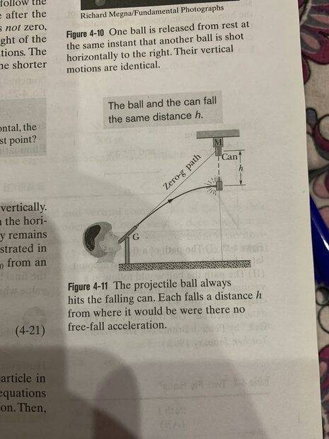

It says when the ball is shot the can is released and they both hit each other at the same height ie they travel same distance down. But that is only possible when the ball starts it’s downward journey the same time as the can starts it’s own. Shooting a ball upward direction will give it some upward velocity.
Sure, but the point of the example is that if you aim at the starting point of the falling mass and shoot at the same instant that the mass is dropped, the projectile hits the falling mass. Can you write the two equations to show that this is true?
Likes vanhees71 and Lnewqban
But if we aim upward there will always be upward velocity component. If this velocity component is not zero how could they hit each other.
They will hit if they are dropped from the same height one with some horizontal push and one vertical.
Please just write the equations to convince yourself. This is a classic problem, and a good one to work through.

Are you reading the description of Figure 4-10 or 4-11?
i have problem with 4 11

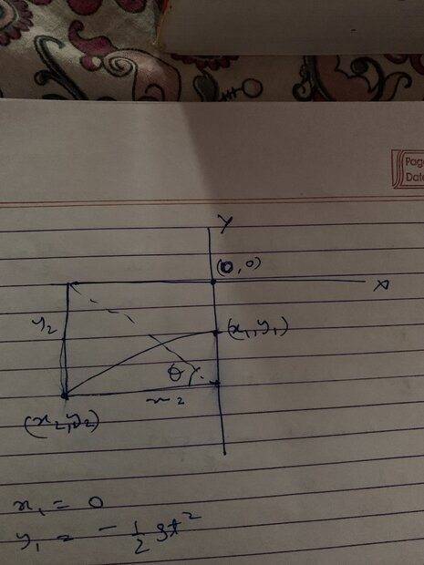

$$\frac{y_1}{x_1} = tan(\Theta)$$
berkeman said:
and x increasing in the direction of the projectile launch point.
How? X of projectile will increase in positive x direction.
You can define the coordinate system, origin and the "positive" directions however you want. As long as you write and solve the equations consistent with the coordinate system definitions, it all works out. I chose positive y down and positive x to the left for my convenience in writing my equations. Go ahead and define the coordinate system however you want if it is more comfortable for you.
Likes Lnewqban

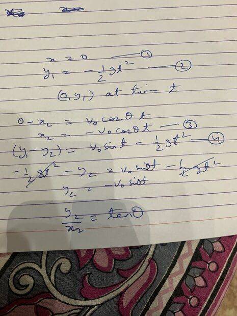

Hmm, I'm not able to follow your work. Can you post a sketch of your coordinate system with the following labeled: ##x_2, y_1, y_2## and say in words what your equations represent?

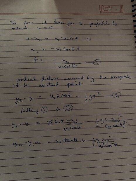

Well, it looks like you are close to doing it correctly, but IMO you are overloading the subscripted variables in a way that is confusing (at least for me). I use the subscript "p" for the projectile and "m" for the mass, so have the variables ##x_p(t)## and ##y_p(t)## to describe the motion of the projectile, and ##y_m(t)## to describe the vertical motion of the mass.
Then the numeric subscripted values can be the starting points of the projectile and mass, and the end point where they meet. I had ##x_1## and ##y_1## as the starting point of the projectile, and ##x=0## and ##y_2## as the point where they collide.
If you are writing up the solution for somebody else to read and grade, it's best to be clear about what each variable is and use a bit of text as you work along to explain why you are writing a particular equation.
@rudransh verma , you will find it much easier to write your equations in a form that everyone else can follow, and you will get better and more helpful answers, if you use Latex as @berkeman suggested in post #12 above.

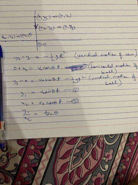

@berkeman i am not getting to the answer
I basically have to make x1=x2=0 and y1=y2 after time t.
It's a bit difficult to follow some of your writing. Looks like you found the time it takes for the projectile to cover the horizontal distance. Good!
And you found the vertical position of the projectile at that time. Good.
So, what's the vertical position of the can at that time? (Express its initial position in terms of the variables that you've been using.)
y1=-1/2gt^2
y1=-1/2gt^2
That's how far it falls. But where did it start from? What is the can's initial position?

Nope. The ball started at the bottom (ground) level, but the can did not. What's the initial height of the can above the ground level?
  • #33
I took the starting point of can as origin
  • #34
You are finding the position above ground level for both, so measure everything from ground level.

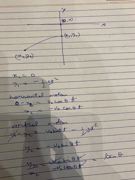

  • #36
@Doc Al Now what?
Again, it's a bit difficult to understand what you've written. Please type out your equations here, not handwritten on paper.
(A) Start here: In terms of the horizontal distance traveled (I'd call it "d") and the angle of the ball's initial velocity (θ) express the initial height of the can.
(B) Solve for the travel time for the shot to cover that horizontal distance. (In terms of those variables.)
(C) Write an expression for the height of the ball at that time. (Measured from ground level.)
(D) Write an expression for the height of the can at that time. (Measured from ground level -- that's where the initial height of the can is needed.)
Compare!
  • #38
I have written 3. I don’t understand how to write 4th
@berkeman help!
So far, so good. For (C) you wrote the height as a function of time -- now plug in the time, which you found in step (B).
For (D), use the same approach but realize that you aren't starting from y = 0, but y = y2 (which you found in step (A)).
