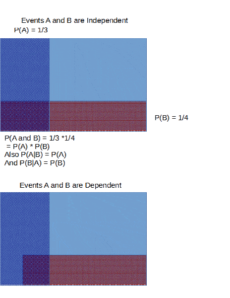

(Correcting an earlier post that I have deleted):
The attachment shows Venn diagrams where the area of an event is the probability of the event. The top figure shows two independent events A and B. P(A∩B)=P(A)×P(B). In the bottom figure, P(B) has been reduced in a way such that the reduction factor of P(B) is not the same as the reduction factor of P(A∩B). So A and B are not independent events in the bottom figure. This is similar to what you did by reducing 70 to 65. You reduced the even numbers by a different proportion from the reduction of (even and divisible by 5).
