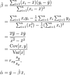

  3. Assume the student uses the equation from the top line (below) to calculate manually the slope of her best fit line. She then uses the rules of uncertainty propagation to propagate the individual y measurement uncertainties through this equation. In so doing, she obtains a value of uncertainty in the slope. How would this value compare to the Excel-calculated standard error in the slope?
That's one form of the equation for OLS (Ordinary Least Squares) regression, which is what Excel uses.
It would differ by the difference between the method she has used and OLS, which is what Excel uses. Is there any statistical basis for her calculation?

If I understand you correctly, the equation from my original post for calculating the slope is the version of OLS that Excel uses. According to that equation, the estimated slope of the best fit line is a function of the individual x and y measurements. Consider that the student used Excel to calculate the slope and the standard error of the slope. The student then used the uncertainty propagation rules pictured above to calculate the uncertainty in the slope based upon the uncertainty in the individual x and y measurements.
How would the standard error of the slope (as reported by Excel) compare to the uncertainty in the slope (as calculated by the student using the error propagation rules)?
If the two values are different, then my follow-up questions are: (a) why is there a discrepancy, and (b) which of the two values is better--the standard error of the slope or the uncertainty generated by the propagation rules cited above in this post?
I don't think the independence conditions of that rule apply to the OLS calculation - think about it, the more points you add the more confident you should become in the fit (unless they are outliers) but in that equation the more points you add the greater ## s_f ## becomes.
If you want to measure the goodness of fit to all the data, search for "linear regression goodness of fit"; I think an f-test is probably a better place to start than the regression coefficient.
How do you estimate the individual uncertainties? Probably as ##\sum_j(y_ij-\bar{y}_i)^2/(n_i-1)## however, the ##\bar{y}_i## are not independent from each other, as they are bound to lie on the regression line. So you need to solve the regression equation first. Also, by assumption, the variances are equal, so you can get a better estimate by using the combined estimate from the linear regression.
