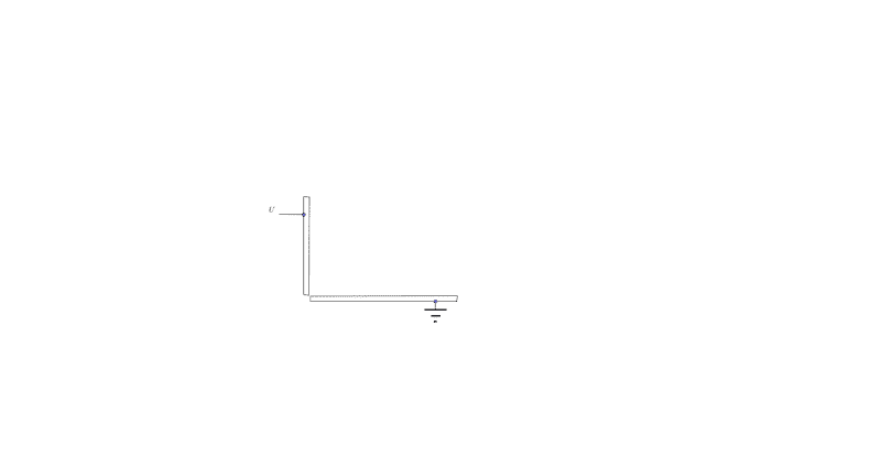

1. We have two perpendicular planes. (See Attachment: sketch1.png) The idea is to describe the electric potential in space. Now you can believe me, that the electric potential is given as ##0(r,\varphi )=\frac{2U_0}{\pi }\varphi ##. The real trouble is to calculate the induced charge on the bottom plate.

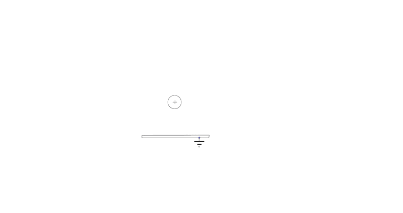

3. A charge above a metal plate. (See attachment Sketch2.png). Again believe me that the electric potential is ##U(r,\vartheta )=\frac{e}{4\pi \varepsilon _0}(\frac{1}{\sqrt{r^2-2rd\cos \vartheta + d^2}}-\frac{1}{\sqrt{r^2+2rd\cos \vartheta + d^2}})## if ##d## is the distance between the electron and the plate. The question is again: What is the induced charge density on the plate?
$$\sigma _{IND} =-\varepsilon _0|\vec{ \nabla }U|$$

1. ##U_0## is probably the ##v## in the figure ? And ##\phi## is some angle, which I can imagine. With two (infinitely long in z direction ?) planes, I can't imagine a ##z## dependence, so I'm a little lost. Can you explain the coordinates ?

That's ##U## in the figure but the figure is so small it looks like ##v##.
Exactly. We wanted to get the potential in space between the plates - 1. quadrant if you want so. Both plates are infinitely long! Meaning we have to solve a laplace equation ##\nabla ^2 U=0## and we did it in polar coordinates where ##r## represents the distance from the origin and of course ##\varphi ## is the angle - naturally ##\varphi \in [0,\frac{\pi }{2}]##.
The solution is ##U=\frac{2U_0}{\pi }\varphi ##. Meaning the potenital is a function of ##\varphi ## only. (Ok I changed my notation on the figure from ##U## to ##U_0##. But I think you get the point.)
I find it strange the dimensions of the plates don't come in. They don't look the same witdth to me, but perhaps it was a given that they are both infinitely wide as well: that would explain why U doesn't go to 0 for ##r \rightarrow \infty##.
OK, so the Electric field is minus the gradient of U. The gradient is $${\partial U\over \partial r}\, \hat r + {1\over r} {\partial U\over \partial \phi}\, \hat \phi + {\partial U\over \partial z}\, \hat z = {1\over r} {\partial U\over \partial \phi}\, \hat \phi = {2U_0\over r \pi }\, \hat \phi$$ In other words: at the grounded plane the E field is pointing straight down. Not in the z direction but in the ##-\phi## direction. That's reasonable: if it weren't there would be a force component along the conductor that would move the charges until E is perpendicular again.
Now the step from E to ##\sigma## is made using Gauss' law, your relevant equation. You find an induced charge density that drops of as ##1\over r##. Seems fine to me... total charge can't be calculated, but that's what you get for infinities.
Your case 3 is worked out in detail here
