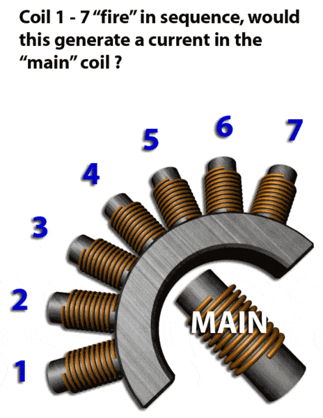

Hello ALL,
I have a question about magnetism and generating electricity in a coil from a group of another coils that are alternately switched on/off (cascade).
Would a current be generated from a group of coils that are switched on and off in sequence, having another coil parallel to them to "collect" the charge ?
Ultimately, you would be repeating the same theory in a generator but with no moving parts... replace the magnets with a group of coils to perpetuate a magnetic "wave" past the collector coil.
Any input or questions welcome!
Please see attachment for visual explanation (rendered art work)
It'd depend on what you did to energize the peripheral
coils.
There'd be very little magnetic coupling between the
central coil and peripheral coils 1,2,6,7.
There'd be significantly weaker coupling between the
central one and 3,5.
Assuming 4 and the central coil are tightly magnetically
coupled they could share some reasonable mutual
inductance.
Anyway the coupled flux from any coil to any other
coil is a function of the mutual inductance of the coils
which is dependent on the geometry and materials and
winding details. If the coils have a geometrically weak
mutual inductance then the induced current in one from
a change in current in the other would be weak.
And there's no such thing as "collecting" charge with
inductors. Induction is the the flux generated relative to
the current flowing, that's all. Mutual inductance is the
flux generated in one circuit as a result of current in the
other circuit.
Also you talk about generators and generating -- the
function of a generator is to convert MECHANICAL energy
into electrical energy; it's the MECHANICAL work that's
done against the magnetic field that 'generates'
electrical power by converting it from mechanical power.
You can couple electrical energy from one coil to another
coil all day long (at a loss of energy due to resistance,
stray flux, eddy currents, et. al.), but you're just moving
existing electrical energy from one place to another
about the same as if you'd conected the circuits with
wires. To 'generate' electricity as in make more electric
than you already had, you'd need a source of mechanical
energy to convert into the electrical energy.
But if you're just asking if the coils would couple energy
from one to the other? Yes, in amounts depending on
the geometry / materials / resistance / circuits / currents.

There would be a dc source on the coils. Each coil would pulse for a short period then the next would be charged (pulse). but fast, maybe 100 times a second.
When you say "coupled flux" are you talking about the point at which the coil and magnet (in a generator) go past each other and the flux (form the magnet) moves through the coil and causes a current to flow ?

What is the effect you're trying to achieve?
I don't think that there's anything about such
a physical arrangement that would be particularly
useful to construct in and of itself.
If you're just trying to couple electrical energy from
one coil to another you don't need to geometrically
arrange them akin to a rotor/stator type of arrangement.
That arrangement is just used in generators
because it's a physically spinning turbine that is being
pushed hard by a mechanical process that is doing the
work that is converted into electrical energy.
In motors it's used because it's the key point of
converting electrical energy to physical rotation energy.
If you're just looking for variable coupling of circuit
energies thatcan be done in a variety of ways without
a geometrical situation like that.

R3KR said:
Thank you for the detailed explanation!
BTW in a generator or motor any pole pieces that
aren't pretty close to DIRECTLY being next to each other
have essentially insignificant mutual coupling.
The motor/generator doesn't benefit from or use the
effect of there being an arc sequence of progressive
coils / fields that have some kind of elusive cumulative
effect.
The only relevant effect is between the two poles that
are in very close proximity, and the rest of them are
just there 'waiting' because at some LATER point they
WILL be in close proximity. Until then, the mutual
coupling is minor compared to that between the ones
that are very nearly aligned.
So the arrangement and sequence of your coils
is irrelevant, there will just be some minor amount of
mutual coupling between any given one and any given
other.
That mutual inductance from any given one to any
given other is the only thing that determines the effect
of a current in one to the flux in the other. The position
or presence of the others is entirely independent of that.
My main goal was to create a field that travels from 1 to 7 inducing a charge in the main coil. I was thinking that, like in a generator, the coil moves past the magnet and creates a charge in the coil.
To replace the magnet with a series of coils which do not move but create a magnetic field that travels across the head of the main coil.
My goal is to induce a moving magnetic field over a coil with no moving parts, there by inducing a charge in said coil
