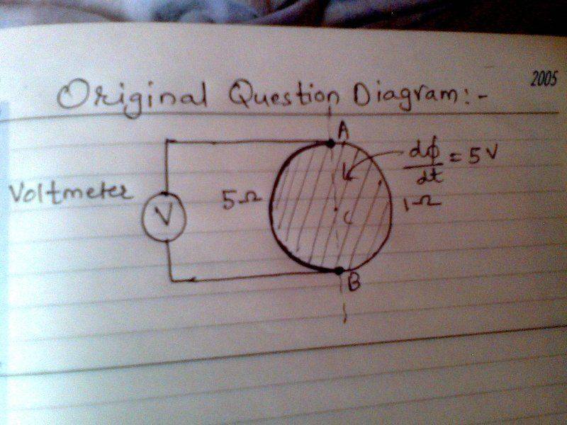

Hi friends..I'm struggling with an interesting puzzle...Suppose there is a circular conducting loop of radius 1/π cm, one half of which is made of a material with resistance 1Ω and the other half from a material with resistance 5Ω. If somehow, one managed to set up a changing magnetic field through that loop such that 5V emf is induced in the loop, what will be the current through the loop? What will the voltmeter read if connected across the two diametrically opposite junction points? Is it really as straightforward as it looks?

This is the original question diagram...Bold half is 5Ω and the other is 1Ω...
OK I see the problem.
Try this and see if it looks familiar.
Draw a dotted line horizontally through the center of the loop - label the left and right intersections C and D respectively.
For the sake of argument, set VA=5V and VB=0 ...
Then, surely, VC=VD=2.5V right?
... that should take care of the second part.
That is, if I am reading the question right.

Yeah that's true for the circular loop. But what about the voltmeter loop? Are you saying that the current through the voltmeter is also due to this magnetic field?
Yes. Every loop around the core will have the same 5V induced in it as long as the entire magnetic flux is inside the loop. That is the case e.g. for a transformer since there the flux is concentrated in the core material. You have two loops here: A-V-B-1Ω-A and A-5Ω-B-1Ω-A (if the voltmeter is on the left side). Both loops have 5V induced in them.
So you can say:
VV + V = 5V
V + V = 5V
IV + I = I
Now you can simply solve that.
One thing you can see instantly is that VV and V must be equal.
I think, you really have to do the calculation carefully, and I don't think that the question is put concise enough. One needs an assumption about the magnetic field. The answer in #17 is correct, if the magnetic field is negligible outside the shaded circular area.
It is also very misleading to say that there's a voltage between the points A and B, and this leads to the confusion. There's no electric potential in this case but to the contrary an electromotive force, i.e., a curl of the electromagnetic field!
Then you can use Faraday's Law in integral form for the path ABV (i.e., along the left half of the wire making the circuit and then through the loop formed by the connection to the volt-meter). According to the above assumption, then there's no magnetic flux through this loop, and thus the volt meter shows
$$U=5 \; \mathrm{V} \cdot 5 \Omega/6 \Omega \simeq 4.17 \;\mathrm{V}.$$
If you put the voltmeter in the right half by the same argument you get
$$U=5 \; \mathrm{V} \cdot 1 \Omega/6 \Omega \simeq 0.83 \;\mathrm{V}.$$
I've assumed I've plugged the voltmeter such that it always shows a positive voltage, which is given by the direction of electric field (i.e. the direction of current-density vector, because of Ohm's Law, ##\vec{E}=\sigma \vec{j}##) in the wire of the loop. I also assumed the voltmeter to be ideal, i.e., of very large resistance.
