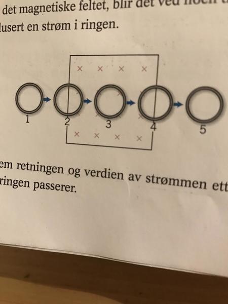

A metal ring with a radius of 10cm and resistance 0.1Ω passes through a delimited magnetic field, look at the photo posted below. The ring has a velocity of 5m/s, and the magnetic field has the field strength 0.4T. When the ring passes through the magnetic field, at some points an electrical current is induced in the ring.
Decide the direction and value of the current as the ring passes through.
Faradays law of induction: ε=-ΔΦ/Δt
I tried to find the induced voltage at spot number two, by using the formula: ε=(-π*0.1m*0.4t)/x
I wasnt really able to figure out the time, since no distances except the radius of the ring are given.
Pictorial hint:
The yellow area represents the area over which there is flux at the present instant of time. During a small time interval Δt, an additional area represented by the blue strip will enter the region of B field.
Likes cnh1995

What I am having trouble with is finding the increase in area in respect to time.
The increase in area is the area ΔA of the blue strip. Express the area of this rectangle in terms of the radius of the ring, the speed of the ring and Δt.

You can solve it using TSny's suggestion. It will involve some differentiation and transformation of variables.
Another approach is to use the effective length of the arc in the magnetic field. Effective length of the arc in the magnetic field will be simply the straight line distance between its two end points. Once you write that length as a function of given parameters, you can directly use the motional emf formula E=B*v*Leffective.
No calculus or variable transformation is needed. Position "2" of the ring is special and finding the area of the blue rectangle is easy.

The positions marked are basically general positions, so position 2 basically goes from where the ring is at in positon 2 in the picture, till it gets to position 3. I am excpected to find a min value, max value as well as an average value for the voltage in all positions.
Can you express this effective length in terms of radius of the ring? Join the two ends of the arc in the magnetic field and express that length in terms of known quantities or variables.
Hint: Rectangular to polar conversion..
OK. Sorry for the misinterpretation.
The area of the ring starts from zero and increases to maximum area , then constant for some time after that the area decreases to zero

The equation for emf comes out to be sinusoidal.

I mean when the ring is entering the field region, the emf is sinusoidal. Once it is completely inside the field, there is no emf for some time. When it is leaving the region, there is again a sinusoidal emf.

Though it is moving, the rate of change of flux through it is zero when it is completely inside the region. So there would be no emf in the ring once it is completely in the field.
Thinking in terms of motional emf, the effective length of the ring becomes zero when the ring is completely inside the field region, making the emf (BvLeffective) zero.

Are you assuming that the angle subtended by the effective length (from the center of the ring) increases proportional to time?
TSny said:
As the ring enters (or leaves) the field, I get that the emf vs time graph is part of an ellipse.
Effective length of the arc in the magnetic field would be the length of the segment joining the ends of the arc.
We can express that length as Leffective=2rsinθ, where 2θ is the angle subtended by the arc in the B-field.
Now, as the loop enters the region, doesn't θ vary from 0 to 180°? This should make Leffective vary sinusoidally, from 0(completely outside) to Lmax(half in) to 0 again (completely inside).
Yes.
I used rdθ=dx, which gives dx/dt=v=rdθ/dt.
Is that a mistake?
When the ring is entirely inside the magnetic field the left and right side of the ring exposed to the same amount of flux and since the ring is closed no emf can be generated
x = r cos(θ/2) where x is distance of center of ring from edge of field region and θ is subtended angle of effective length.

It may very well vary as the sine of some angle, but that angle is not changing uniformly with time.
Consider the rate of change of area as the ring moves at constant linear speed.
(I concur that it is half an ellipse, the top half on the way in and the bottom half on the way out, or vice versa.)

So Leffective=2rsinθ.
Which means motional emf=2Blvrsinθ.
This equation is sinusoidal w.r.t. the angle θ, but since θ doesn't vary linearly with time, the equation is not sinusoidal w.r.t. time. Is that correct?
  • #32
cnh1995 said:
I'll work out the math later.
Yes, the equation is indeed of an ellipse.
Thanks @TSny, @haruspex for catching the mistake.
