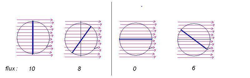

See the figure. The red lines represent the magnetic field lines. The flux is the number of the lines crossing the cross section of the loop (drawn by blue)
The flux is shown in each position of the loop. It is maximum when the loop is perpendicular to the field lines, that is, vertical . Turning from the vertical position with some small angle, the flux decreases from 10 to 8.
In the horizontal position, the flux is zero, and turning the loop with the same angle as before, the flux increases by 6.

I understand now, from your diagram, that the flux changes as the cross-section of the loop covers fewer lines or more magnetic field lines. What I don't understand is how that affects the amount of current. Why isn't a loop parallel to the external field lines creating a current of 0, if it's not crossing any of the flux lines? How does that cause more of a change in the magnetic field than if you were crossing over 10 field lines→which creates no current?

The current is proportional with the change of the flux. Turning with a small angle from the vertical position of the loop causes small change of the flux and the flux changes most around the horizontal position of the loop.

How is it that in the vertical position, less of the flux is changed, when you are crossing over more flux lines(10, in that diagram)? This, in comparison to crossing over say 6 in the fourth part of the diagram.
That's what's confusing me.
Or is this some lower level detail that is beyond the scope of my knowledge?
In the first picture, the loop is vertical and 10 lines crosses it. In the second one, the loop is turned by some small angle and you count 8 lines crossing it. The change of flux is -2.
In the third picture, the loop is horizontal initially and crosses no lines, the flux is zero. In the fourth picture, the loop is turned by the same angle as previously, and crosses 6 lines. The change of flux by turning the he loop is 6.
Mathematically, the flux is proportional to the area perpendicular to the magnetic field, which is the area of the loop multiplied by cos(α), the cosine of the angle, enclosed by the field lines and the normal of the loop. The cosine is zero at 90° angle, (horizontal loop) and changes fastest when the angle is changed. When the loop is vertical, the angle is zero, the cosine is 1, and its change is the slowest.
