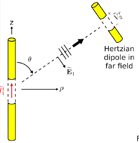

Hello, I need to calculate the expression for a current on two dipoles separated as shown in the attached full task .
I need to present a solution,lets take the simplest case.
Theta_in=0
I need to find the expression for the currents on the dipoles.
https://eceweb1.rutgers.edu/~orfanidi/ewa/ch24.pdf
My E-field is in Z direction and the phase is a viarable of X.
1.What expression should i use to get the current on the dipole?
After that i opened chapter 25
https://eceweb1.rutgers.edu/~orfanidi/ewa/ch25.pdf
I see that there are expressions for mutual impedance.
2What strategy do you recommend me to use to get the current on the other dipole?
Thanks.

Hello berkerman, first of all I want to see what current is being induced on a single dipole.
So the question is what formula should I use for this purpose?
I have the following manual
https://phys.libretexts.org/Bookshelves/Electricity_and_Magnetism/Electromagnetics_II_(Ellingson)/10:_Antennas/10.11:_Potential_Induced_in_a_Dipole
from the manual formula (10.11.7)
$$\widetilde{V}_1^r = -\widetilde{\bf E}_2({\bf r}=0) \cdot \hat{\bf \theta} l_e \nonumber$$
(latex is not converting code into formula)
is the right
What is my l_e and E(r=0) given my task?
Given that this the correct formula ,How given Voc i get the induced current on a single dipole?
