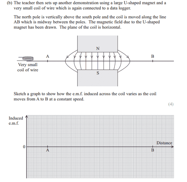

Induced EMF graph of a very small wire moving through a coil
In summary, the induced emf for a small loop moving at a constant velocity between the poles of a magnet will initially increase as it cuts more flux lines, then decrease as it cuts flux lines in the opposite direction. However, if the loop is fully within the magnetic field, there will be no change in magnetic flux and therefore no induced emf.

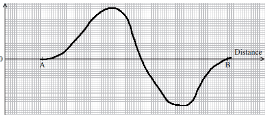

I believe the graph will start initially curving upwards, because it begins to cut more and more flux lines which lead to an increased induced emf. Once it is "fully" within the magnetic field, it will slope downwards to a negative induced emf as it begins to cut flux lines in the other direction. The peaks will have the same induced emf as the velocity is constant so the rate of change of flux should be equal for entering and leaving the coil. My solution was like this:
It's wrong, but I can't quite understand.
The loop is small which means it spends some time entirely between the poles of the magnet. While doing this, is the magnetic flux through it changing? If so, how?
I guess the magnetic flux isn't changing, because it's moving at a constant velocity. So that would mean no increase/decrease in the rate of change of magnetic flux, so no induced emf?
Yup.
