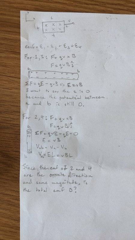

The link you attach is referring to a rod moving through a magnetic field. The emf induced in a rod if the rod, magnetic field and velocity vector are all mutually orthogonal is ##\mathcal{E} = Blv##.
You might consider your loop to be a rectangular frame made up of 4 individual wires/rods, with one pair of sides parallel to the velocity vector and the other two orthogonal to the velocity vector. Suppose the magnetic field is normal to the plane of the loop. What is the EMF induced in each loop (pay attention to their directions...)? What is the total EMF around the loop?
The work is in the photo. Essentially, I think the emf of the two horizontal sides is 0 and the emf of the two vertical sides is vBL. Since the vertical sides have the same direction and magnitude, they cancel and the total emf is zero around the loop. Is this correct?
That's essentially correct, yes. Hopefully that satisfies you that everything is still consistent!
The way I like to think of it is in terms of the vector triple product, ##\mathcal{E} = (\vec{v} \times \vec{B}) \cdot \vec{l} = vBl\sin{\theta}\cos{\phi}##. If all 3 vectors are mutually orthogonal this reduces to ##\mathcal{E} = Blv##. If at least two of ##\vec{v}##, ##\vec{l}##, and ##\vec{B}## are parallel, the whole expression becomes zero.
