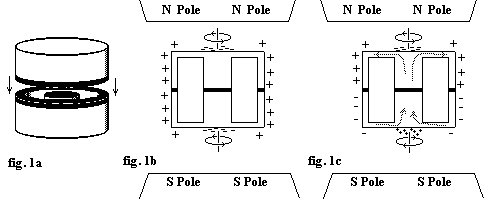

Sorry for being unclear. However, I believe that the answer was implied by the statement:
I rotate it on its axis at a constant angular velocity, and so the electric field E produced is non-solenoidal and can be described as the negative gradient of some potential V(x,y,z).
So, I believe this implies that the magnetic field density B is not changing, which in turns implies that if the cylindrical magnet is rotating, it must be doing so on its axis of symmetry. It took me a few hours to write the post. Making pictures may take several more!
Fortunately I found a relevant picture. Fig 1b below may help:
