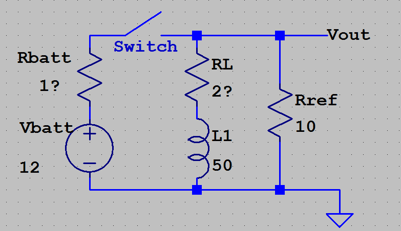

I am thinking of measuring inductance of an inductor by applying a DC voltage onto it. Then, calculate L = V/(di/dt).
I wonder if the series resistance (R) of the voltage source plus of the inductor under test would cause much error.
So, I derive the transient responses of the cases with and without R. I calculated the error between the two cases and got the indeterminate form.
I would like to know how to properly analyze this problem?

Inductance range 10uH to 10mH
Voltage = 12Vdc
Current and period of time are < 3 A and 10 ms (may be)
I have just got an idea. I will just apply the 12Vdc until the inductor reaches its steady state to measure the series resistance (Rseries = 12Vdc/I_steady).
Disconnect and reconnect the 12Vdc again. This time, monitor i
Vseries = i*Rseries ----> v_L = 12 - Vseries -----> L = v_L*delta t/delta i
The inductor should always be paralleled with a resistor during the test. When the supply is switched off, the negative voltage inductive spike is then attenuated, preventing damage to the inductor insulation. For the same reason, the switch should not be in series with the inductor.
Avoid diodes if possible. They introduce more problems than they solve. I have used, and suggest a circuit like this, for the meter.
Note that when the battery is switched off, after the long "charge" period, Vout produces a negative step, that then decays to zero. The initial positive and then negative voltage of the step, give the internal resistance of the inductor. The inductance can then be computed from dVout/dt as the current begins to decay in the Rref loop.
