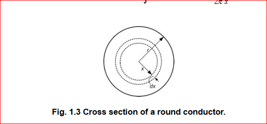

I have read this chapter about calculating internal and external inductance of a straight wire here.
http://nptel.ac.in/courses/Webcourse-contents/IIT-KANPUR/power-system/chapter_1/1_4.html
Seeing the flux linked with the conductor itself, emf due to that flux induced in upper half and lower half of the wire are in opposite direction. How does this internal inductance work? How is back emf generated by the flux linked with the conductor itself? Thanks in advance!

When the current is switched on, the magnetic field expands cylindrically. It starts with a maximum at the centre of the wire and expands outwards, cutting "shells" of the wire as it does so. If you use Fleming's Right Hand Rule, for a generator, the direction of the induced emf in the outer shells of the wire can be found, taking the radially expanding direction of the field as the Motion. Once the current reaches maximum, the field is completely built, and energy is stored in it until switch off.

Could you please elaborate? How does the field expand cylindrically?
So you know that the magnetic field surrounds the conductor rather like lagging around a pipe. It gets stronger towards the centre, and it goes right inside the conductor. So the centre is the strongest point. And when you switch on, the field starts in the centre and expands outwards. As it does so, it is cutting layers of the conductor and so causes a back EMF.
http://nptel.ac.in/courses/Webcourse-contents/IIT-KANPUR/power-system/chapter_1/1_4.htmlSeeing the flux linked with the conductor itself, emf due to that flux induced in upper half and lower half of the wire are in opposite direction.
Perhaps we're stumped by QV cross B in that image from your link?
What is relative motion between V and B ?
Likes cnh1995
If I visualized correctly, the flux inside the conductor will cause back emf opposite to the current direction inside the wire but since this emf will have a closed path, the return path would be on the surface of the conductor. That means, inside the conductor, there is opposition to the flow of current by the forward path of back emf and on the surface, the back emf assists the current. This leads to skin effect as the current tends to flow on the surface.
