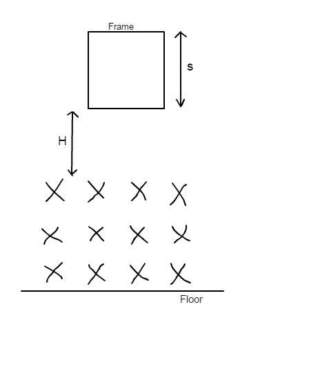

"Consider a square metal picture frame of side length s, mass M, and total electrical resistance R. It is dropped from rest from a height H above a region of uniform magnetic field pointing into the page. The frame accelerates downward under the influence of gravity until reaching the magnetic field. It is observed that, while entering the magnetic field, the frame moves with constant velocity. What is the frame's speed when it begins to enter the magnetic field? What is the strength of the magnetic field? (Solve for B in terms of the given physical quantities (s, M, R, and H) and any constants you need.) After the frame has completely entered the magnetic field, what is the frame's acceleration? Justify your answer in two sentences or less."
[tex] {V_{f}}^2 = {V_{i}}^2 + 2 a x [/tex]
[tex] F_{mag} = \frac{v l^2 B^2}{R} [/tex]
[tex]F = m a [/tex]
First I found the velocity after the metal frame dropped a height H:
[tex]V_{f}^2 = V_{i}^2 + 2 a x [/tex]
[tex]V_{f} = \sqrt{ 2 a x } = \sqrt{ 2 (9.8 \frac{m}{s^2 }) H} = 4.4 H \frac{m}{s}[/tex]
Then I reasoned that the only portion of the square metal picture frame that would factor into the magnetic force was the bottom horizontal portion. I figured that the two sides were moving in the same direction as velocity, and therefore the cross-product would go to zero. I also reasoned that the top horizontal portion would not matter, because as soon as this portion reaches the magnetic field, the flux is no longer changing and there will be no induced magnetic field, and therefore no magnetic force.
I approached the next portion as a dynamic equilibrium problem. Since the velocity is constant, I summed the forces in the positive and negative y-direction. Downward I have [itex]F_{gravity} = m g[/itex], and upward [itex]F_{B} = \frac{v s^2 B^2}{R}[/itex]. I then set them equal and solved for B, obtaining:
[tex]B = \sqrt{ \frac{M g R}{4.4 H s} }[/tex]
After it completely enters the field, I assumed that its acceleration would return to [itex]9.8 \frac{m}{s^2}[/itex] because the flux is no longer changing, so no fields are being induced.
Is this at all on the right track?

Vf and B are both wrong. Redo, leaving all parameters in terms of symbols rather than numbers until the very end. You are missing chances to check dimensions term-by-term as you go. You got all the right relations and then blew it by introducing numbers prematurely.

That's the area, not the length. The length is 4s. But I'm not sure why you are interested in it.

Problem is, @PhysicsChick, that only one of the four sides gets the mag. force in the vertical direction.

I got [tex] B = \sqrt{\frac{MgR}{(\sqrt{2gH})s^2}} [/tex]

That is right, and is probably what monkeyminbd would have gotten had he/she stuck to symbols to the end as you did.

I don't want to over-dramatize, but that is one of the most important things to learn in your physics studies.
So now try also to check units in each term. I prefer the term "dimensions". Like, force would have dimensions {F} = MLT-2, M for mass, L for length, T for time. When you get into elec. & magnetism you have to add Q for charge. You can deduce the dimensions of B for example by the familiar formula
F = iLB so B = F/iL and so {B} = {F}/{i}(L} = MLT-2/QT-1 = MLT-2Q-1TL-1 = MT-1Q-1.
Or, from ampere's law B = μi/L, {μi/L} = {B} which means that {μ} = {B}{L}/{i} = MLQ-2.
