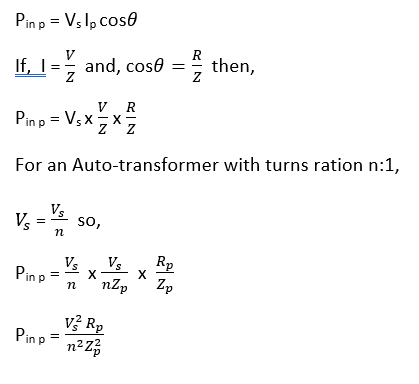

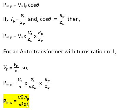

Thanks for replying Jim, here's what I have snipped from MS Word:
Please let me know if it looks good.
Aha ! Same exact thing we figured out up above. from the basics.
But what MS Word document is that from? Your text ?
So what happens to that expression for power when you insert the turns ratio √3 ?
Might it make sense to divide the terms at the two applied voltages?
That's often a handy little algebra trick that reduces the number of unknowns.
It's my MS Word document, I'm just writing the answer to the question up, I find it easier to type it up in the equation editor in word as opposed to the text box provided.
I'm not sure I understand your comment, I thought I was simply proving the final equation or do I have to go a step further and substitute the (√3)^2 which would obviously replace the n^2 with 3?

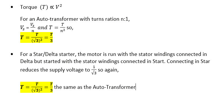

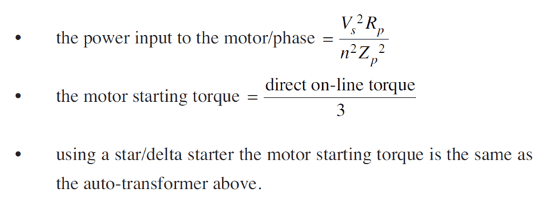

For the next two parts of the question I have the following:
Likes jim hardy
I think you have now answered all three of the questions in your original post.
Bravo !
you might annotate your snip with comments
to help you remember should teacher ask you to explain it to class.
Be ready to clarify why cosine of current angle is the same as .cosine of impedance angle Rp/Zp.
I would rehearse a blackboard demonstration "just in case".
That might sound vain, but if he doesn't ask you don't have to admit to it.
Boy Scout's Motto "Be Prepared"
old jim
