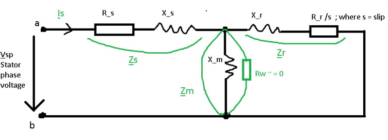

Given the 3-phased induction machine working as a motor in AC, please see the following diagram attached below, and its parameters.

Following the main s (stator) branch, the m (magnetizing) and r (rotor) sub-branches are in parallel as they can be seen in the attached diagram.

I think I am doing something wrong because Kirchoff's Law, doesen't seem to apply such that the the sum of the currents sub-branches Im+Ir > Is (main current).
Was expecting Is (main stator current) = Im+Ir (as the 2 sub-branches run in parallel)
Furthermore the Joule Stator Loss seems to be enormous Ljs =11.81 kW given that the stator Power was calculated as Ps =16.367 kW.
For sure I did something wrong, and I still didn't realize it, and that's why I need your help. I would be more than grateful if someone could check my calculations. Many thanks!

Once again, I'm reading the Forum with my phone and my eyes aren't what they used to be. I'll check later with a large PC screen. Lm is too small
Likes Martin Harris
Right, okay. Thanks a lot!
That was the given Lm = 0.01 H
I just find it weird that Kirchoff's Law, doesen't seem to apply such that the the sum of the currents sub-branches Im+Ir > Is (main current).
I checked your calculations and, at first glance, found no mistakes.
I insist, Lm is too small. This motor has no core!
No wonder the stator current is huge and the power losses shoot through the roof.
Let's assume the motor has no load (s=0). If you repeat the calculation will find the stator current is still too large. This is crazy. A good motor with no load should have a low stator current.
Likes Martin Harris
Your calculation-it seems to me- is correct [except some calculation insignificant errors since in my calculation Im+Ir=Is, indeed]. But Pmech has to be less-you have to subtract the ventilation and mechanical losses.
Likes Martin Harris
I agree with Gordianus: the motor data it is not for a real induction motor [efficacity 24%? and stator copper losses of 72%?]. However it is only a theoretical exercise, I agree]
Likes Martin Harris
I wonder if the electromagnetic torque should be exactly the same (identical) to the shaft torque.
I guess that's feasible if we assume negligible friction.
