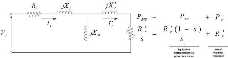

I would be more than grateful if someone can confirm these calculations.
Many thanks!
Your calculation, it seems to me, is o.k. I have only the following remark:
If according to Steinmetz schematic diagram of an induction motor Rr*(1-sn)/sn*Ir^2=Pn then Rr*Ir^2=Ljr=sn*(Pn+Ljr) and sn=Ljr/(Pn+Ljr)
Now if Pinput-Ljs=Pn+Ljr then sn is o.k. However, Pinput=Pn/0.9=5555.56 and Ljs=213.33 then Pinput-Ljs=5342.2 and Pn+Ljr=5000+142.2=5142.2 W .In this case sn=0.02766.

I was told $$\frac {Ljr} {Ljs} = \frac {2} {3}$$
I was just given the following formula:
$$sn = \frac {Ljr} {Pelectromagnetic} $$
where sn = nominal slip, Ljr = 142.2222 W and Pelectromagnetic = Psn - Ljs - LFe = 5555.5555W - 213.3333W - 75W = 5267.2217 W
Hence I get sn (nominal slip) = 0.02700
I don't get where I am comitting the mistake.

By-the -way, in my opinion the power losses Lfe and Ljs may be extracted from rated stator power and ventilation and friction [mechanical losses] from Pgap [then Pgap=Lv+Lmech+Pn+Ljr] neglecting Lfe for rotor where the frequence is very low [sn*fstator] and the iron losses depend on B[magnetic flux density] and frotor.
