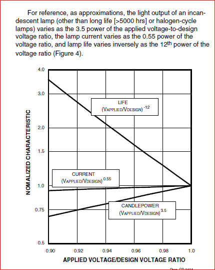

Some places you'll see 12th power
point is, it's dramatic.
http://www.allegromicro.com/~/media/Files/Technical-Documents/an295012-A-Primer-On-Driving-Incandescent-Lamps.ashx
##\frac{250}{248} ##^3.5 = 1.028, 2.8% brightness change for 0.8% voltage change
