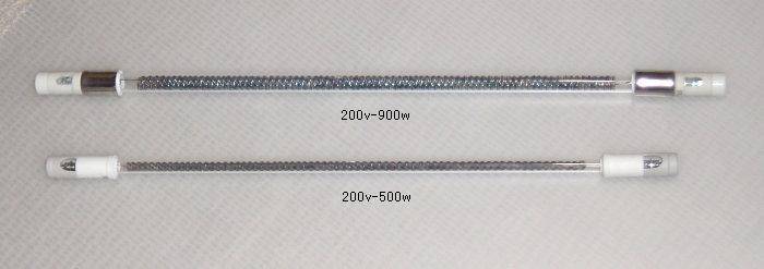

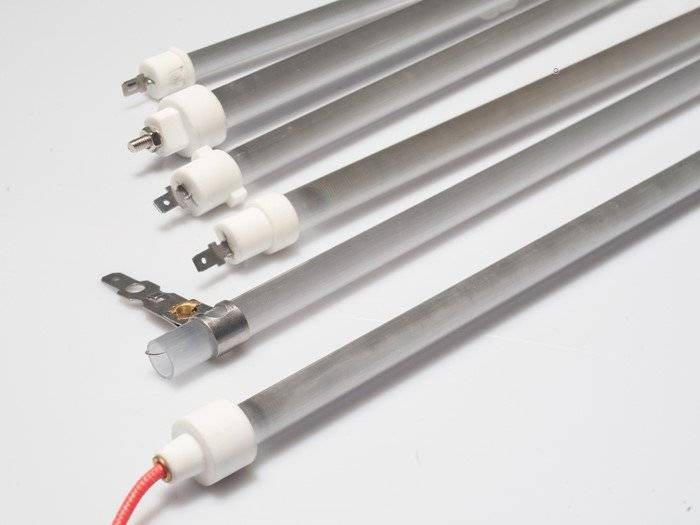

bogue said:
Is resistive electrical wiring robust enough to interact with the fluidization and the movement of the reactor? In industry I never see it on reactors/heated units, only pipes.
Pipes are really convenient forms for heating elements.
Of course, placing the heating element in metal pipes are just another convenient option if direct contact is desirable.
