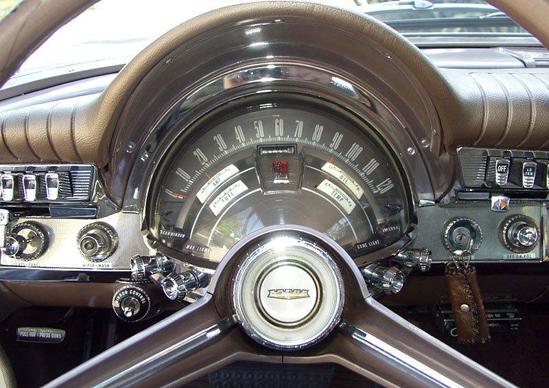

My advice - get a '62 Chrysler dash and steering gear it's sooo StarWars.
photo credit to this guy
