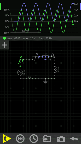

what is actually happening when an Inductor is connected with an ac source.(i mean at the very instant of connection is made).i know emf will be induced due to change in current.(curl of E is =-time derivative of B)here my confusion is,inorder to induce emf,current should flow first,then who limit the magnitude current(is it infinity at the very first time?)...and how will be the current wave form at the very instant of connection. i want to know what is the physics behind it not mathematical equations..please helpme

So what happens when you connect it to an AC supply? The answer depends on what time in the cycle you close the switch. Let's say you close the switch when V=0. Then rate of change of current is zero. As V builds to maximum, rate of change of I increases. When V decreases to zero, rate of change of I will be zero, and thus I will be at maximum.

It is clear to me.
Let's talk about a purely inductive circuit, so R=0.
Now, the forcing function is sinusoidal and its equation will depend on the angle at which you close the switch. Let's say you closed the switch when the sinusoidal voltage is at positive zero crossing.
So,
Ldi/dt= Vmsin(ωt)
So,
Ldi=Vmsin(ωt) dt
Integrating, we get
Li=-Vmcos(ωt)/ω+c...1)
Now at t=0, current through the inductor is zero because there is no initial current as the voltage is switched at t=0.
So,
1) becomes,
0=Vm/ω+c... (cos 0=1)
I.e. c=Vm
So, i(t)=Vm/ωL-Vmcos(ωt)/ωL
It will look like this.

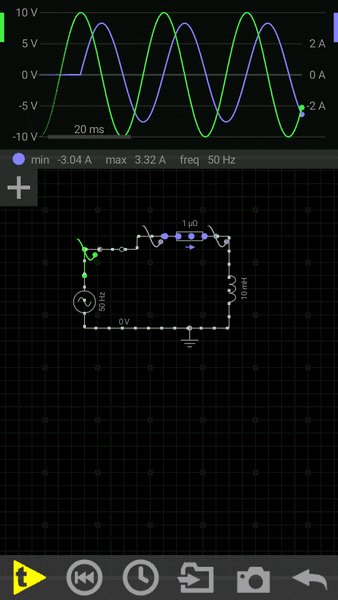

@pranav p v, I edited and fixed some typos in my earlier post.
Now, as they teach you in ac circuits class,
the current lags the voltage by 90 degrees but only when you close the switch at the voltage peak.
Let's analyse that mathematically.
Ldi/dt=Vmsin(ωt).
∴Ldi=Vmsin(ωt)dt
∴Li=-Vmcos(ωt)/ω+c
At t=π/2ω i.e. at voltage peak, current is 0.
So,
0=-Vmcos(π/2)/ω+c
∴c=0.
So,
i(t)=-(Vm/ωL)cos(ωt).

This only I mentioned in #7,#9...So you are saying that there is an offset dc component is present there ??waveforms u showed here is the actual wave form right?in that how to say current is lagging?
Yes. The dc offset is present initially. In R-L circuits, it dies out exponentially because of the resistance and after a few cycles, only sinusoidal current remains. In case of purely inductive circuit, this dc offset does not die out and is present there all the time. The only time you have zero dc offset is when you close the switch at the voltage peak.
The dc offset is maximum when you close the switch at voltage zero crossing and is zero when you close it at the voltage peak.
You can't say the current is lagging unless it is a symmetrical waveform. The terms lagging and leading are used for sinusoidal signals (sin and cos) only, with no dc offset.
Hence, you can say current lags the voltage only in the second case i.e. when there is zero dc offset.

So if I use a simulator for this purpose ,is it show current waveform with that offset value?( simulator because ideal inductor is no there)... And for this condition what will be the avg power?
For purely inductive circuits, average active power is always zero no matter when you close the switch. You can see it from the graphs.
Yes, you can use a simulator. The waveforms I've posted are actually the screenshots of the simulations I ran on my phone.
